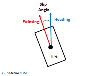

What are these tires going on ?? As said above, aspect ratio is always a compromise. The taller the tires' sidewall, the better the tire absorbs road irregularities. But the sloppier the steering/cornering response, especially at higher speeds. The shorter the sidewall, the stiffer the slip angle will, be. This is the difference between the angle of the rim on a turn and angle of the tire when turning.
