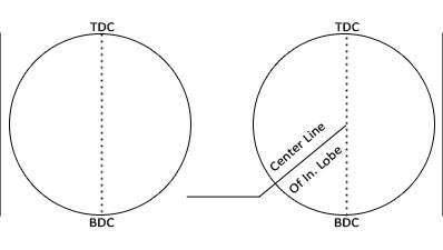

107 lca in at 102
the 107 gets the intake closed earlier shows 63 degrees After Bottom Dead Center

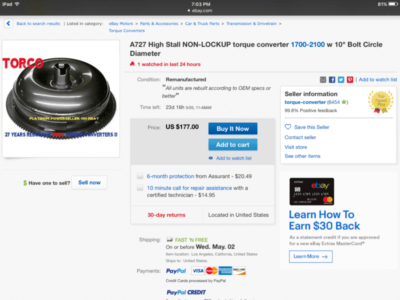

The vert attached will need the smaller stock 10" flex plate. It also will need to have the balance weights attached for a cast crank ( if you didn't swap for a forged one) ask the eBay seller to attach them or buy a set of weight through Jegs and weld em on yourself.

The add of a converter posted by 727 is a piece of junk and the advert is somewhat misleading. First off it's not "high stall" at 2100, second there's no brand name or manufacturer mentioned, third a 6 month protection and "call" charge is ridiculous and fourth I must have been hosed because my PTC cost me $700. But my performance went up and my highway mileage did as well with no overheating of the tranny or creeping at idle. Guess I'm one of those "born every minute" with no complaints.

On a budget, I usually just get a stock rebuilt Hi-Stall converter from Transtar or other local rebuilder. Ask your transmission guy. You need one with the same balance weights, but I'm not sure what number? Maybe a CR23H? Most of these 11" converters (10" bolt circle.) are in the low to mid 2,000 RPM stall range.

Well his thumper is a 227 intake 241 exhaust 279-296@.006 I do not see how he needs that much exhaust Intake closes 63ABDC
but the 107 lca allows him to install on a 102 Intake Center Line and he could go down to 100 to get intake intake closes 61ABDC
let's compare this chevy master grind with the MOPAR XE275HL which is shorter 231-237 275-287 but gets .525 lift Intake Closes 64 ABDC
