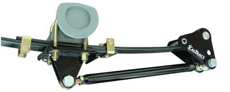

what cal-trac set up are you using? inquireing minds want to know.
The same set up as this, but i'm running Mopar XHD Springs and not Calvert Racing Mono's like in the pic:
