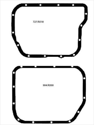

Hey guys I wanna know what transmission did my car came with? its a 66 dodge coronet with a 318 automatic, column shifter. Any help will be great I wanna know what can i replace with, and what other Dodge can i get it from?
which pan do you have?
The Internet is an amazing thing.

A 66 Coronet with a 318 would have come with a 904 automatic. The only SB's in cars that came with 727's are the 340's in A-Bodies from 68-73 and the 360 in A and B-bodies from 74 to around 80. I think trucks came with 727's when equipped with a 360 from 72-80.
The 904 can come from any Mopar with a 318 from 66-80 and the 727 can come from A-Bodies from 68-74, b-bodies 71-80.

Pay no mind Joe, I appreciate your knowledge... Im sure its all fun and games. I got a kick out of it. I'll be taking a look at my pan today and Ill post what the car has, once and for all.:read:
I would like to apoligize. When I made the first post, I mistakenly thought the 66 318 was an LA series engine. My post was referring to the 318 LA series engines from 67-80 which used the 904 auto behind them. I have never personally seen a 318 LA motor with a 727 behind it with the exception of maybe heavy duty and truck applications. 67 was the first year for the 318 LA series engine so if a 67 coronet has a 318 poly in it it is not original.
Joe
all 66 8 cylinder cars had the 727 the 904 was not used until 67 or 68. Keep your 66 transmission its the best one it is the first year that had the linkage shifting and the last year that had the rear pump.
