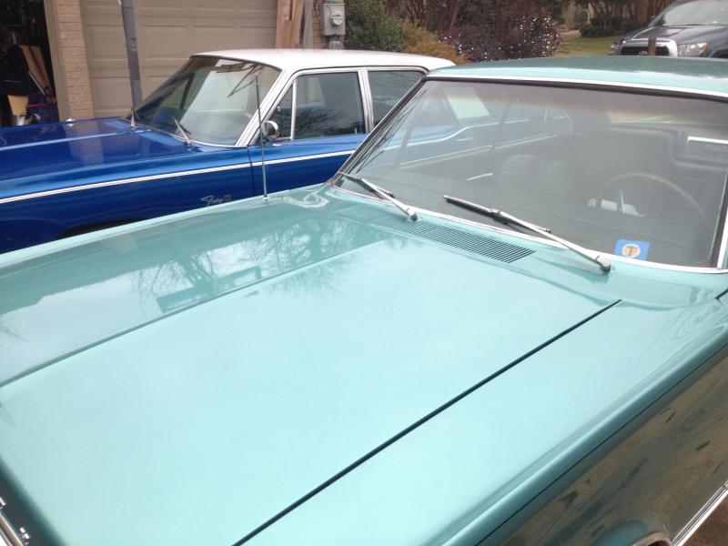

My rebuilder runs Dexron 3 in 727s unless it's a lockup converter. He's been doing these about forty years and reached that conclusion through experience. He just finished (this morning! :icon_kidra: rebuilding Lone Star's original 727 and put in a heavy duty clutch pack, Transgo TF2 shift kit and proper torque converter. Lone Star is the '67 383 Satellite.
