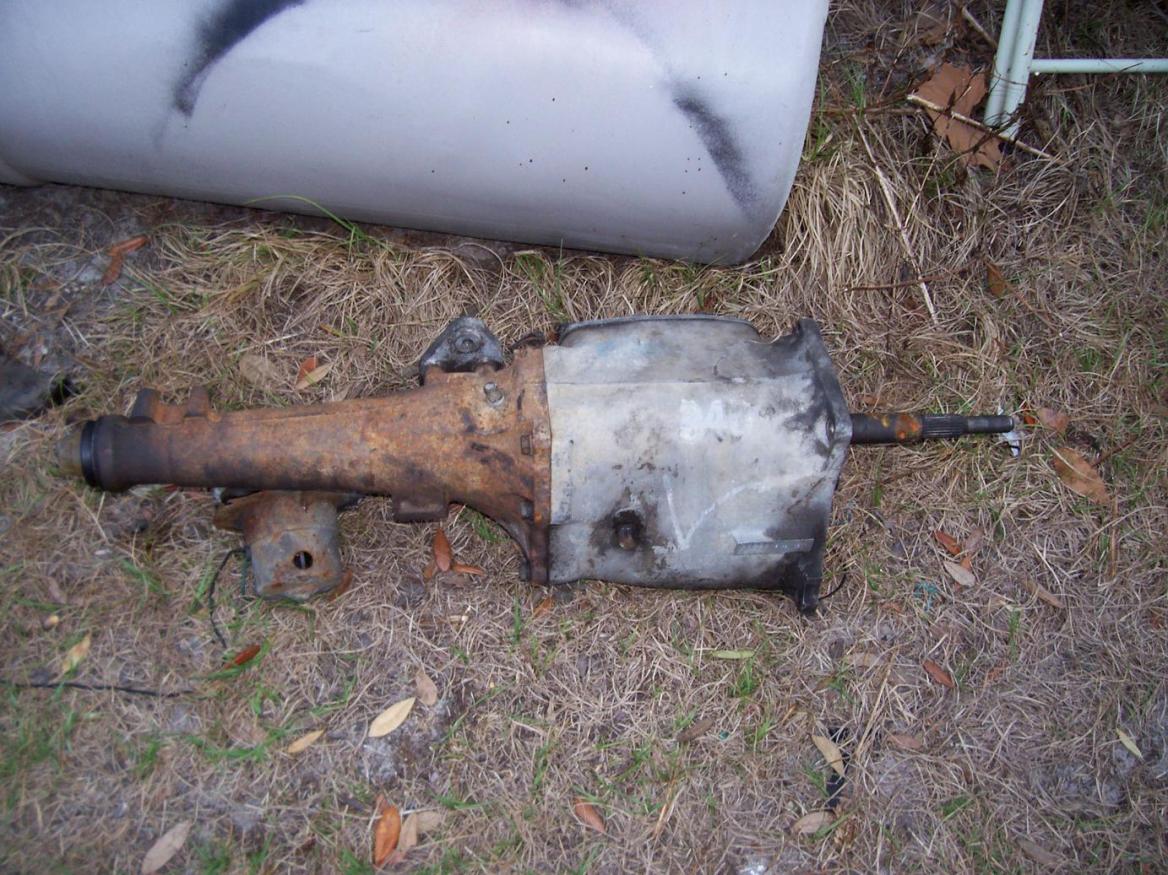

the later factory overdrive (truck/van )will work as long as you don't drive it. 600 horse is alot for those .I have them in two of my cars with small blocks and they break easy without alot of effort..................That is just my experience,I'm sure someone has had one in there car for years and never broke it. I BEAT ON MINE !! I go to the track, and I drive them everywhere,not just around the block a few trimes a year.Why else would you have a stick in your car :angel1:
but I got one for sale if you're a gamblin man :idea1:
