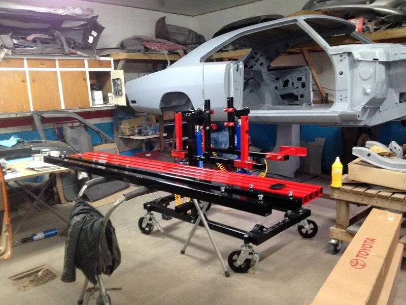

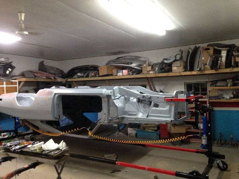

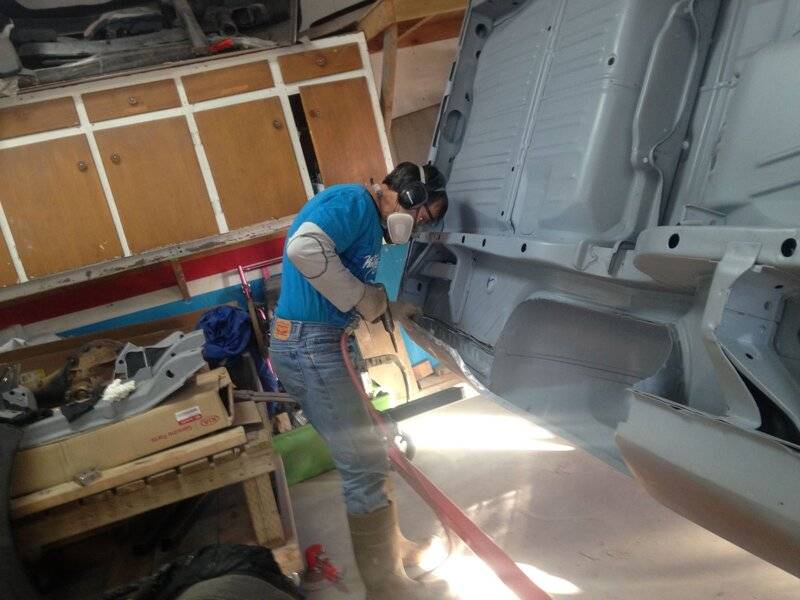

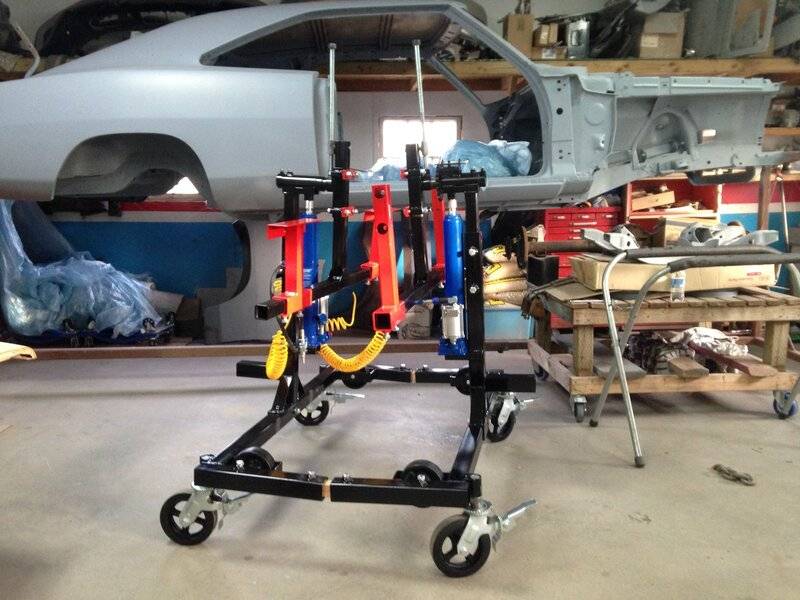

Well if memory serves me correctly, I think Stanton's start at around $1400 Canadian plus shipping. That price is from 2017. With all the upgrades that I did I ran it up to around $2200 Canadian. It would be less in the good ole US of A. Upgrades?? Purchased two air activated jacks plus air fittings. I had to purchase the frame extensions separately (needed) along with storage extensions. (not needed). I also added scaffolding wheels so we could roll it easily over grass and uneven surfaces. (Works nice outside) and lastly we epoxied it and painted it up two tone. Pay that much for it no use in letting it all rust up. Might help with resale later??
Here are a few shots of Stans handy work.

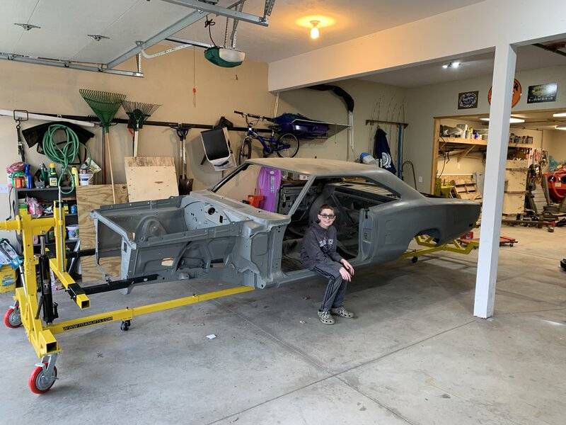

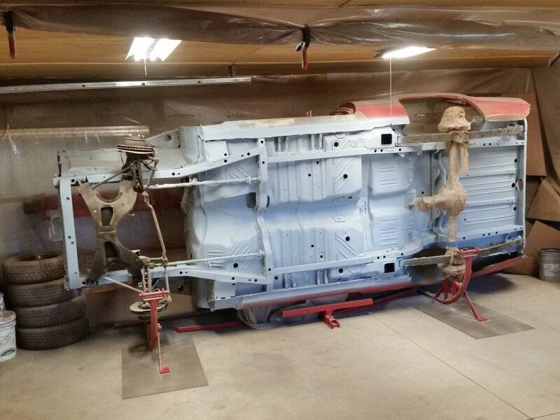

I bought one of the Titan ones. The yellow one, I believe its rated fro 4500 pounds. Works well, cost to my door was about 1450. The only complaint I had is where tubes are supposed to fit inside of tubes on it the outside tube was welded and the interior welds were a bit heavy and made that not as smooth operating and assembly as it could have been.

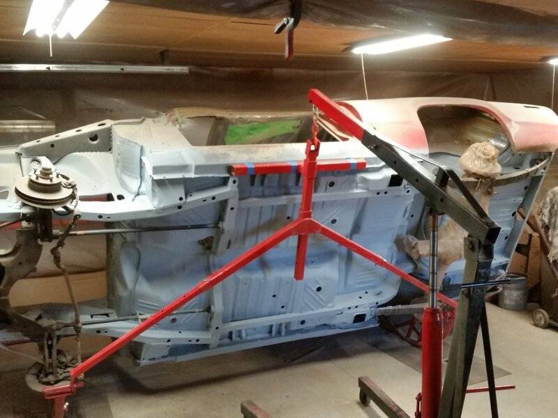

For those of us that only have an 8 ft ceiling height in the garage, I used this style.
It bolts to the wheel flanges.
One person can use an engine hoist to bring it down.
