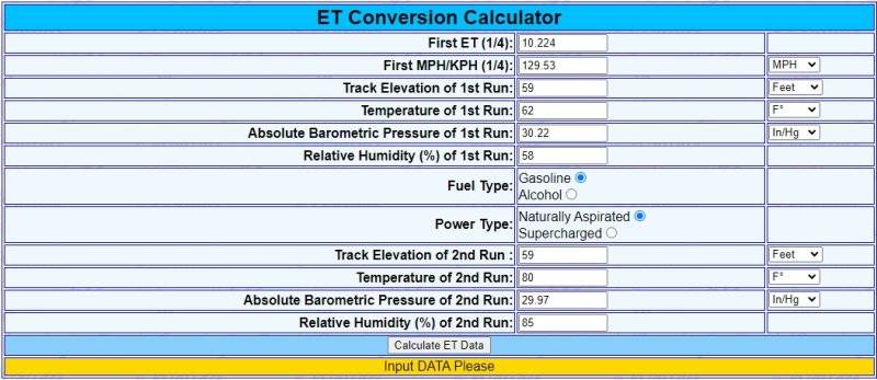

I guess I don’t understand the calculation. Why isn’t 59 ft used for the track elevation? Verses 223 ft and 2240 ft

I'm assuming you used corrected barometer. You need to use uncorrected barometer which will account for track elevation.
I was using the DA number from the weather site for track elevation. It looks like that was my mistake. I re-ran the calculations using the actual track elevation and came back with much different numbers. Using the data below, the corrected ET went to [email protected].
