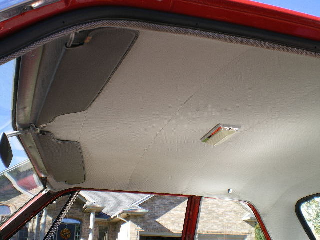

This is my 64 Belvedere, I don't know if the mirror is wrong or the sunvisors are wrong
Mirror would take visors with tips
Dart - The visors are wrong. The correct visors have tips that clip into the mirror mount. New ones can be purchased from various vendors.

I was hoping the mirror was wrong as it isn't in nice shape and the visors are.

64-5 visors
The car likely would want these.

I bought a new pair from Joe Suchy for $100. They're very nice reproductions. They are white - they will need to be dyed the proper color. Joe is in GA and can be contacted at 770.964.4441.
