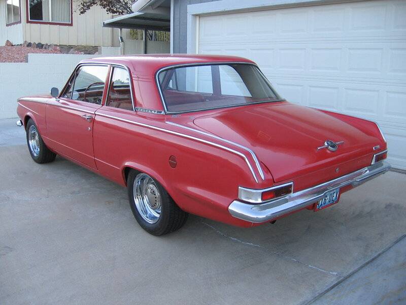

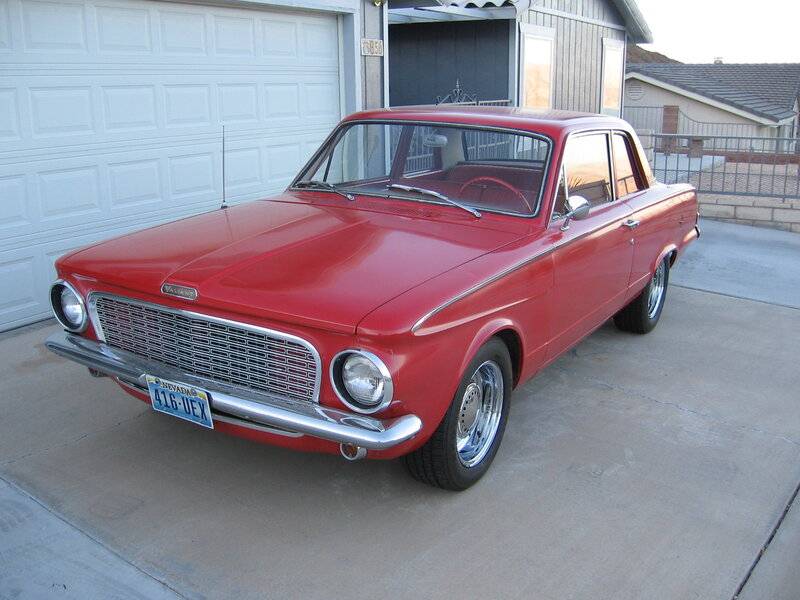

See how deep this wheel is ? I had these made many moons ago by Stockton Wheel
I wanted 15x7 small bolt pattern chrome wheels.What I didn't know was to ask for standard offset.
As you can see I got "Reverse". Luck-a-lee they worked fine only rubbed on the upper outer wheel house with 4 people in the car on turns.
Remember the Chrome Reverse wheels of the old days ? Negative !
As you can see I got "Reverse". Luck-a-lee they worked fine only rubbed on the upper outer wheel house with 4 people in the car on turns.View attachment 1291093
Cool looking Valiant!!!
