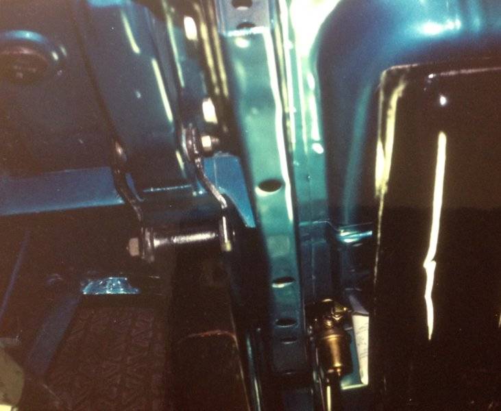

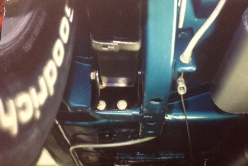

Reading your post reminded me of my old Dodge in the early 90's and how I made some extra room at the leaf springs. A couple of pictures to show:
I fab'd some offset front brackets. Still bolted into the stock holes. I drilled a hole on the side of the frame about 1-1/4", and fed the nut up through the factory hole underneath.
I used an offset shackle at the rear. Looked and worked great.
