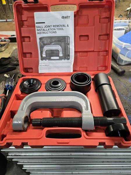

I Used a ball joint tool to remove and replace on car with no hammers or air tools
