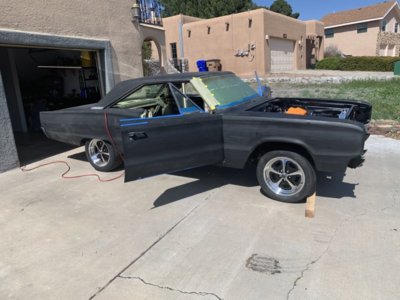

275 60 15 on cop rims on a 67 Coronet. Stock suspension... it fits with little room to spare, no rubbing at all.
17x7 fronts and 17x8 rears
225/50 front and 245/50 rear
perfect clearances all the way around, could go bigger in rear if wanted but not much more, front is tons of room.

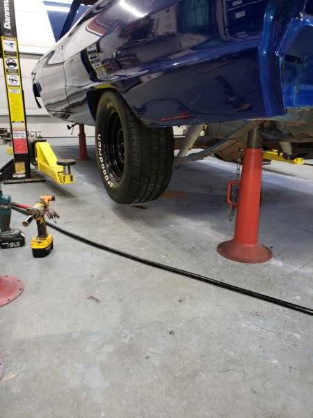

pic is when it was in 4x4 mode lol sits a lot lower now and still has all the same room

If you look at Sniperhockeys car height, ( based on supplied picture) the rear wheel well barely covers the tire tread... Look at mine and its way down into the wheel..... I wanted my car low, so I will say a lot of difference in car height here..

My point on here is the lower a car sits the less room it has in its rear wheel wells... That is why I always say 245's were as wide as I could go... If a car sits higher, sure, you can get larger tires and wheels under it...
