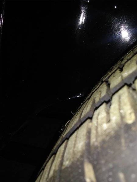

Heres what my rear wheel well looks like
Whatever you use, black them out.
Looks funny when guys leave wheel wells body color.
