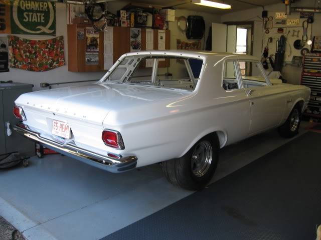

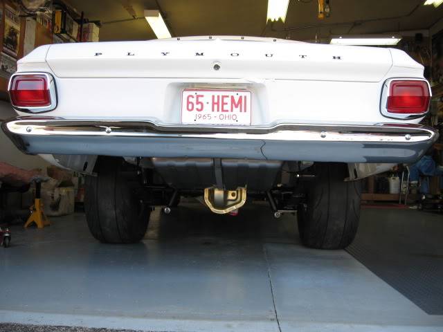

The '65 is minitubbed with relocated springs. It has 315/60/15 M/T drag radials on 10" torq-thrusts. Don't recall the offset of the wheel. The dana was cut to fit.
Tried a buddy's 31x16.5-15 M/Ts on 12" wheels. Looked great. Snug fit but fit. Stayed with what I had rather than buying all new again.
