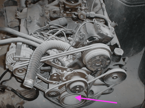

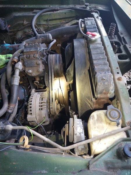

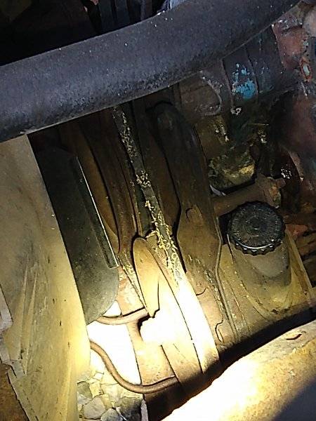

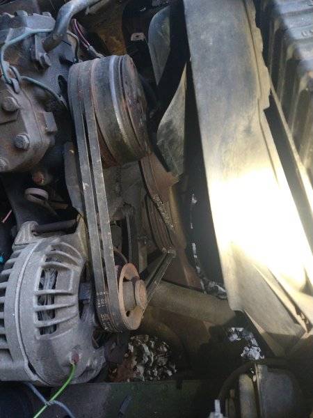

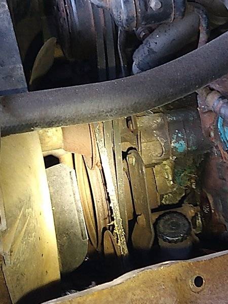

Thanks! How high do you think the car has to be? Also this is kind of out there but do you think it would be smarter to just let a restoration shop do it so I don't make anything worse? The engine only has 35k miles on it so it would suck if I did something to ruin it.Maybe this will help... It's a big block but the crank bolt is in the same place so it really doesn't matter.... You can see the bolt you need to put a breaker bar on is below the water pump, now put the fan on there & try to reach it.... Thats why some suggest getting access from the bottom... And they are right, access is better... Still not easy but better.... Also you can see the bolt is recessed into the crank pulley hence the suggestion of a short extension.... If you try to use to long of an extension first you'll be in the fan, next you'll hit the fan shroud & finally you'll run into the radiator....
The other way to get there is to pull the fan & shroud out, then access is much better... It should take some effort (50-80 ft-lbs) to turn the engine with an 18" breaker bar but you shouldn't have to really lean into it...

i have had good luck moving it by the fly wheelWhere do I put the breaker bar to try and crank it? The engine is locked up. 1971 Plymouth satellite 318View attachment 1335996View attachment 1335997View attachment 1335998View attachment 1335999
