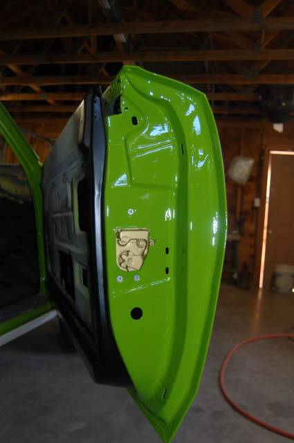

1970 GTX. FF4 Exterior and EF8 interior. Does the exterior colour cover the whole door opening area. The B pillar where door striker is all the way round to the front hinges? Including the hardtop where the weatherstrip is and the bottom where the sill trim screws on. Is all that exterior colour? What about the sides and bottom of doors, would I be right in thinking that all that area is the exterior paint and the interior paint is only on the door part that faces inside? If anybody knows or has pics to show that would be great. :eusa_think: thanks
This is the only pic I could find right now (of my car), but you pretty much use the holes for the door weather strip to mask off for interior paint. All the door jambs, hinge area, striker area are exterior color. Mask off at the weather strip line and paint everything inside that interior color.

My car...green exterior, black interior....
Thanks for the info, every bit helps. Charger looks great by the way.
