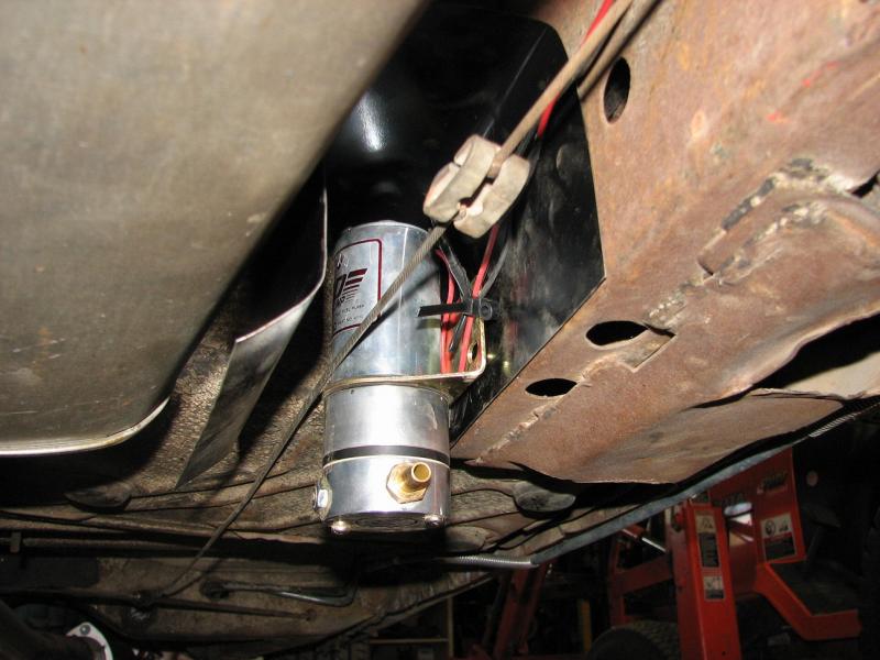

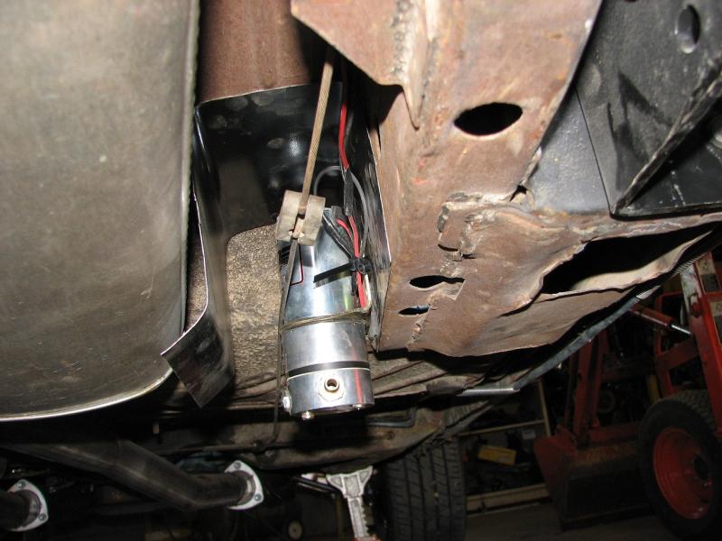

This is a pic of where I am putting mine right now. It is on the passenger side frame rail. I put it as far forward as I could to try to keep the exhaust heat off of it. Its about Put a heat shield around it to keep some of the exhaust heat off it. I am running a stock fuel tank. I haven't run with it here yet though!

normally you want electric pumps as close to the fuel sorce as possible since they normally have poor suction compared to output.if you are running a stock or mild engine then it wont make much difference.but,if you are running a hot motor,you may have fuel delivery issuses.
Yeah - I'm with you.
I am hoping that the distance below the tank will help make up for the distance from the tank in this spot. Giving me the advantage of gravity. The bottom of the pump is about 6 inches below the tank in this location.
I have also mounted a full-flow filter back on the passenger frame above the pump to help keep it primed. It is about 40-42 inches forward of the tank though.
I mounted mine on the floorboard basically just in front of the differential mounted so the top/bottom of the pump run "north/south" on the car. This puts the pump about 1 ft. from the fuel source (stock tank) and away from the exahaust heat. The rear end will get no where near it even at full suspension travel and I've put pumps there for 20+ years without a problem. The only negative is that it does have a very noticeable sound inside the car, but some rubber spacers on the attaching bolts or something like that might help.
