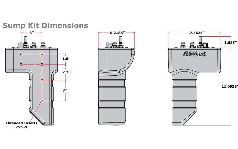

Hey guys I'm in the process of fuel injecting my 73 roadrunner. the car as of right now is a 318 auto car with ac but I am in the process of building a 440 for the car which has been kinda slow going. I already have the edelbrock e street system sitting aside for the 440 so I decided i would put it on the 318 and give it a try as its just a matter of punching in the new engine parameters when the engine is swapped. The kit I got included a a universal sump which is basically a mini fuel tank with a high pressure pump in it for the throttle body that your mechanical pump keeps filled and I cant seem to find a place on this car to mount it. I had originally planned on removing the charcoal canister and putting it there but it seems to be too tall as the ac lines run over and the hood would also hit it I believe. I'm going to attach the dimensions and maybe some one else can come up with something or knows someone else who has installed this in a 73-74 B-body. sump-kit-dimensions.jpg
how much room is there in front of the radiator? or where the horns / radiator overflow tank is?
I'll try and post a picture of the engine bay after. I also thought about in front of the radiator but it's too tall. Right now I'm thinking if I relocated the battery to the trunk then I may be able to put it there.
