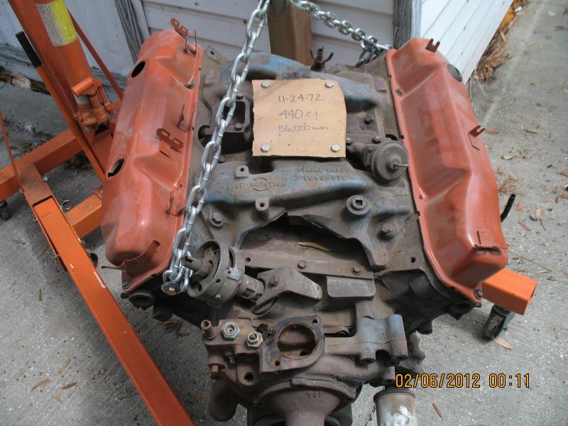

bought a low mileage 440 out of running imperial i.e. good compression, no ticks, checked with a bore scope .

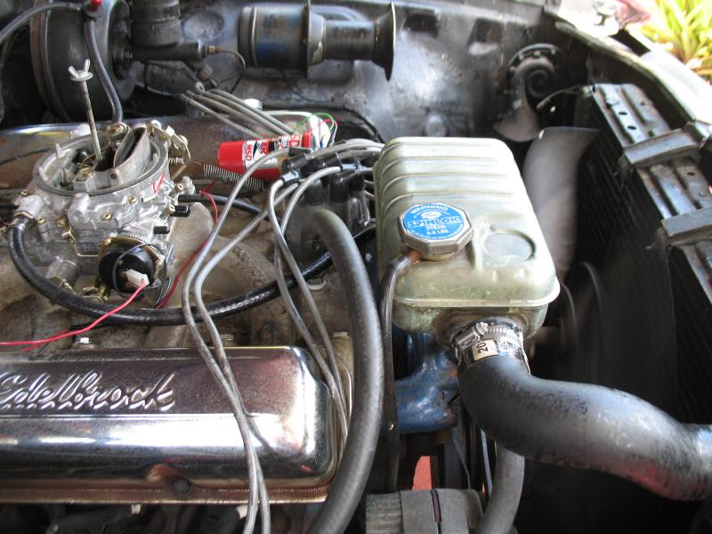

kind of want to build it and forget it. car is for the street . figure it needs seats for the crap gas(aftermarket heads too $$$ for now) so stock heads, cam with a little more lift , carb, iggy, high flow water pump and better radiator (maybe a pusher fan for city)with shroud. here is what i am starting with.

You won't use the full grand but man the switch from 318 to 440 nickel and dimed me. Judging by your pics I suggest electronic ignition, Belts, Hoses, Pulleys, new alternator, voltage regulator, plugs, wires, antifreeze (12 bucks a gallon), temp and oil pressure sender, thermostat, hoses, headers, gaskets, exhaust work possibly, oil, filter, heater hose bung going into water pump housing exc.
The water pump on that motor is on the passenger side. Where was the 318 exiting? you may need a new housing, which means gaskets and while you have it down you may check the timing chain for slop and a new pump.
I didn't do all of the above and my daily driver was not reliable until after the above (minus timing chain). Is your 1K extra on top of what the little things or is that what is left of the budget?

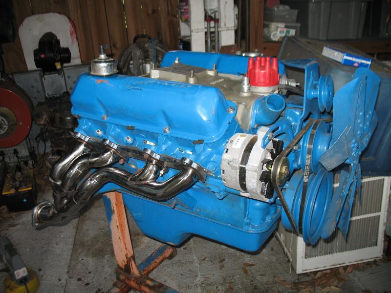

ok lets retitle this where to put $4k in a 64
looking for intake and carb suggestions
what i got
rebuilt 440 w/ 906 heads 8.5-1 (i think)
compcam http://www.compcams.com/Company/CC/cam-specs/Details.aspx?csid=700&sb=2 .(their recomendation is 700-800 cfm)
mallory iggy
tri-flo headers going to 2 1/2" straights
727 (stage 3 shift kit)
unkown gearing (need to tackle that soon)
car is for commuting to work and grocery runs oh and eating prisus's
a nice performer rpm ,holley street dominator , TEAM G, not really sure what the cam spec's are.
It says replacement 440 cam, so u mite want to use a stock iron. idk. Carb's are up for debate always...
I'm using an eddy 800 avs electric choke on my Coronet and going with a carter avs 4640 on my Charger(only because it came on the car and want to save $ for other things). Both having 440's.
You could get a little crazy and put a 6pac on.
