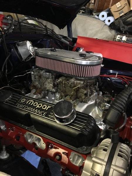

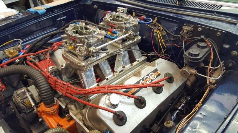

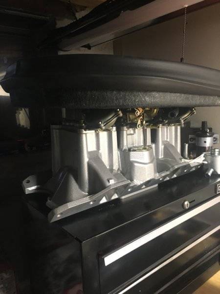

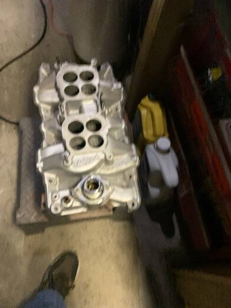

In order of appearance;
A gag shot of my M1-TR and a pair of TQ’s.
(Though I guess I could actually do that.)
My old and now sold Edelbrock TR5 w/the thin top.
My small block 6 pack. Engine being built now by me.
