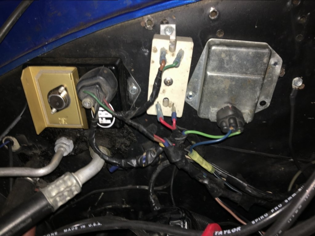

Yea, being as it is a non stock replacement they are not black like original. You could always switch your old connector to the new wiring? also I mentioned above that it requires a 4 prong ballast, which you said was good, because you already had it. Reading the description on YO, I forgot to mention that it uses the 70 and later style alternator and voltage regulator. If you dont want to get those items as well, I would just order a stock replacement harness and wire the electronic ignition into it.
Is the silver box the regulator you are talking about?
Also, I wouldn't mind switching over to a MDS box. If that also changes things up.
Yep, looks like you are already set up for the 70 style ignition. If you are going to go with MSD, I would just order the stock harness then. The ballast resistor becomes obsolete when you go to MSD.
