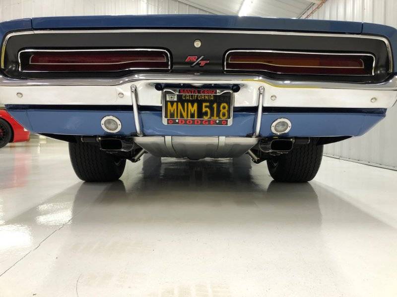

I use the band and position them correctly. They are not visible unless you are on your back. Clamps were used from the factory. Welding degrades the materials and is a sore spot for discoloration. Plus 3 inch fits very tight and once welded its pretty much permanent and you had better pray it never has to come apart. I don't pay for 1k exhaust systems that I have to weld together.

I have the accurate tips. Since the exhaust is ceramic coated mild steel and tips stainless I chose to clamp them. And as mentioned, it's nice to have a little adjustment.
I have a set of the 3" TTI tips... I don't think they look even close to the original rectangle shape... The Accurate tips are much closer to correct....
