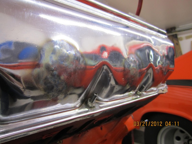

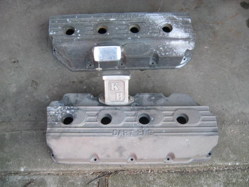

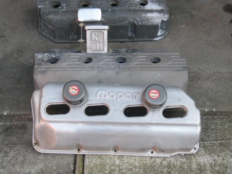

17. Valve covers that do not crack or seal properly used american made 300.00 black wrinkle. or old set of MT covers aluminum weight a pile but dont crack.. Bucks
