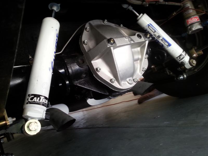

Picture above is of my new Dana 60.

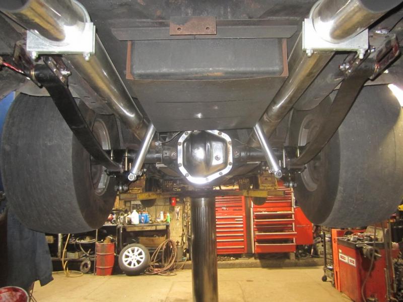

Still have the Dana with a spool that came in my when I bought it 28 years ago.I'm throwing north of 850 ft lbs of torque at it,,,,,,,and it wants MORE!

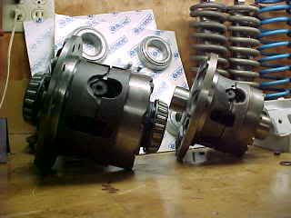

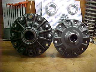

With the 8 3/4, it's not so much as which one is the weakest of the 3 (measure the Dana 60 pinion vs the 741) but when will the teeth shave off of the ring gear? Also look at the size of the carriers from the 8 3/4 vs the Dana 60. Does the 9 1/4 even have a Power Lok Sure Grip or is it the lowly Track Lok? The Track Lok.....well, you can keep that great piece of art work. Here's the difference between the 8 3/4 and the Dana 60 Power Lok carriers....
