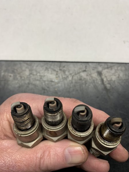

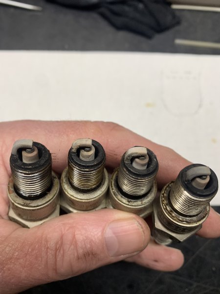

These are my plugs. Passenger’s side then driver’s side.
@dadsbee They've been in 12 years so likely 25-30,000 miles. The car has been hard to start the last couple years after it sits for a few days. I'm wondering if new plugs would help that.
