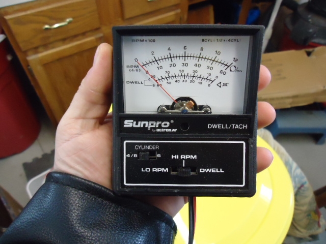

There are tachometers meant for tuning cars. They just clip onto a coil post and the battery. I know I have a few lying around. Check out your local parts store.

Here's what I'm talking about. It checks dwell on old points ignitions but also has a tach to help with tuning.
If you run a MSD ignition with stock type tach or aftermarket analog tach like a Sun tach. It wont work, you'll need a MSD Tach adapter.
