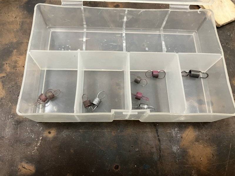

I found a new set of the Mr gasket springs in the garage, so will try to change out the heavy spring.
(I also have extra stock springs, so that is also an option.)
I would like to come in with total around 2500.

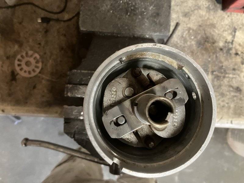

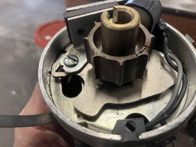

Man, I looked and looked for the plastic gauges I had that came from either Mallory or Accel. I could not find them anywhere. These were used as spacers to set the amount of total advance these Mopar Performance distributors can have. Here is a tip: If the distributor shaft looks like it is made from brass:
..instead of a standard steel color...
...it could be the MP unit with the light weights and springs.

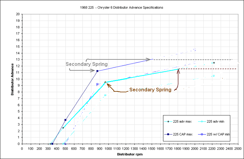

I wanted to plot a graph at 1000, 1500, 2000, 2500 and 3000 rpms.
Sort of like this:

With regard to the comment about the shaft being brass....it is very possible that it either: brass plated, steel that is zinc dichromate plated but not brass, as there are several types of brass, the most common bring 80%-20% copper-tin or 70%-30% copper-tin. Color is not the determination of a material's composition......just FYI....

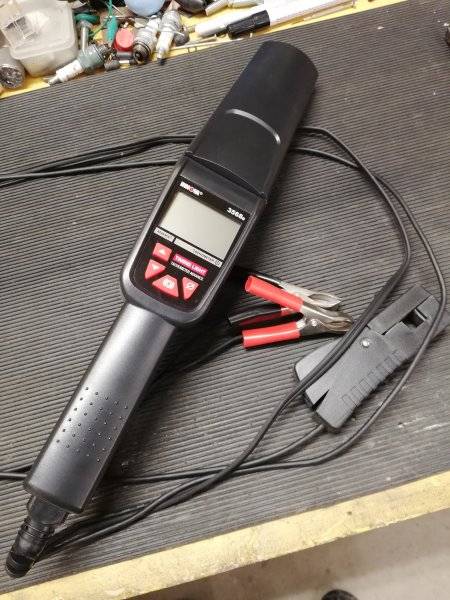

I really like this one, very solid

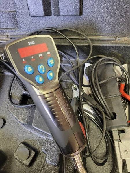

I've been satisfied with mine since I bought it 20+ years ago but the ones with the tachometer readout are interesting.

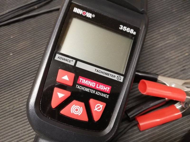

anybody here old enough to remember when all we had was a simple light (no inductive) and we'd put a safety pin in the #1 plug wire (and keep it there) at the distributor?
if you're trying to measure distributor degrees each .0154" of travel in the slot is one distributor degree. i use number drills to measure that distance and divide by .0154. vacuum advance is different and i have to admit i've never got it exact but around .011" of movement is one distributor degree.

Lookie what I found!
These are for adjusting the advance on a Mopar Performance unit.
The Gauges are from 14 degrees to 28. Who the heck needs 28 degrees of advance???
If you’re at 12 degrees of initial, that puts you at 40 degrees total.
From this angle you can see the difference in thicknesses for them.
The spring kit is sparse.
