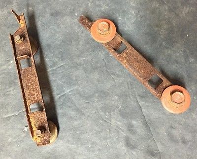

I made these for my 68.
when I got my 68 the deck lid was just placed on. found out later these trunk bolt brackets, nuts, what ever there called where missing. Don't know if anyone is remaking these, I find them on ebay and found a few around town but what the hell I had time to kill so I came up with these.
What was missing.

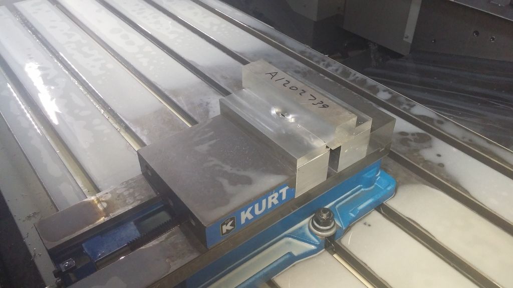

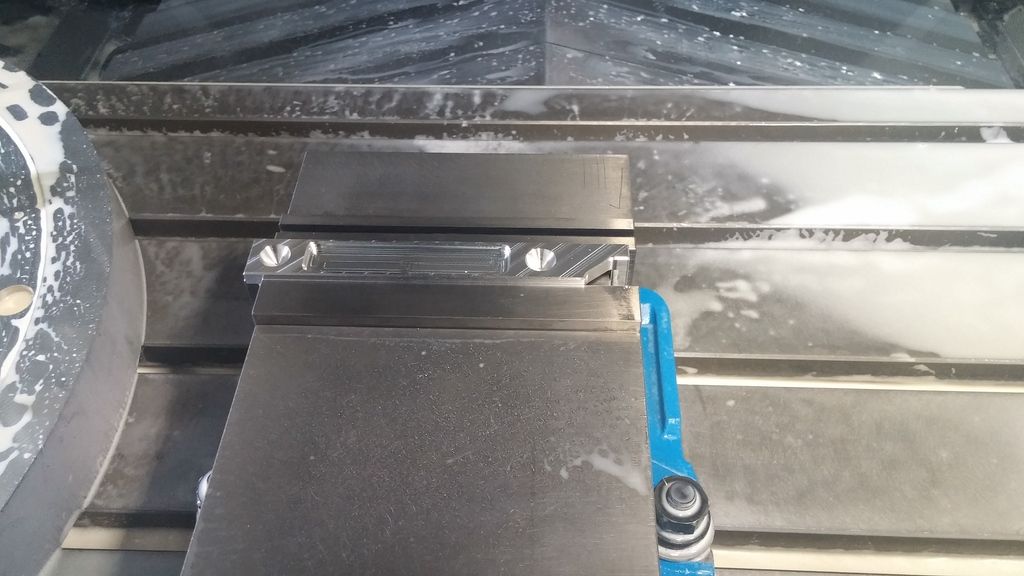

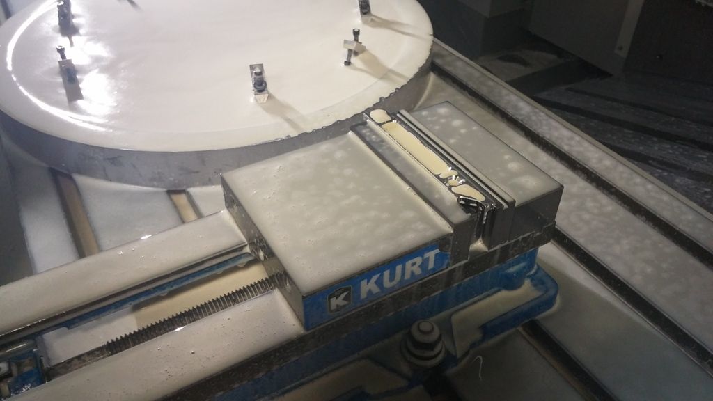

Put in a block of 6061-T6 aluminum
15 minuets later.

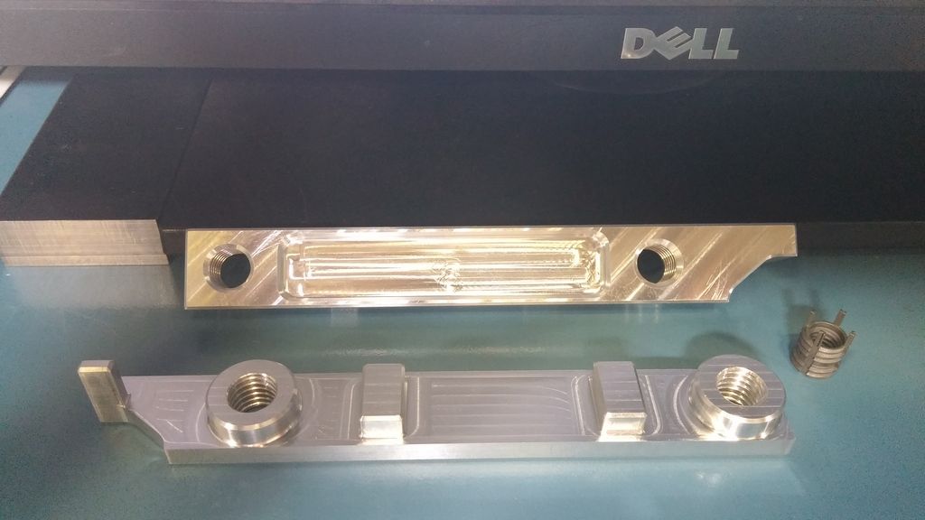

Cut the back stock off. I still need to take a few thousands off the sides, radius and pocket the back side, drill and tap for some keenserts, but so far so good. Everything was programed off of pictures and my hinge, I didn't have the original bracket around when I made them.

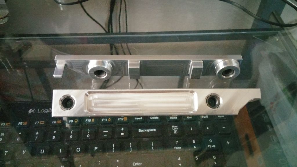

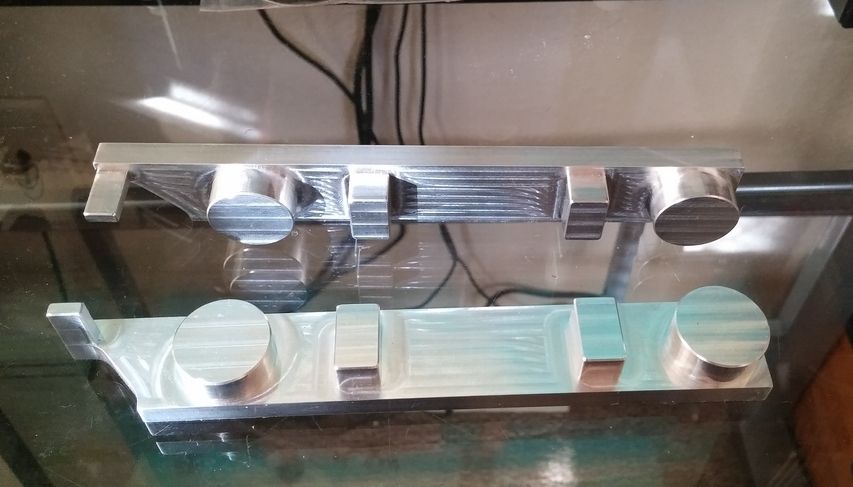

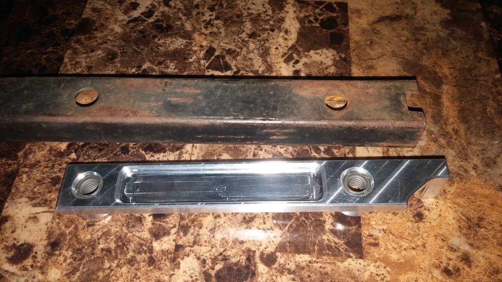

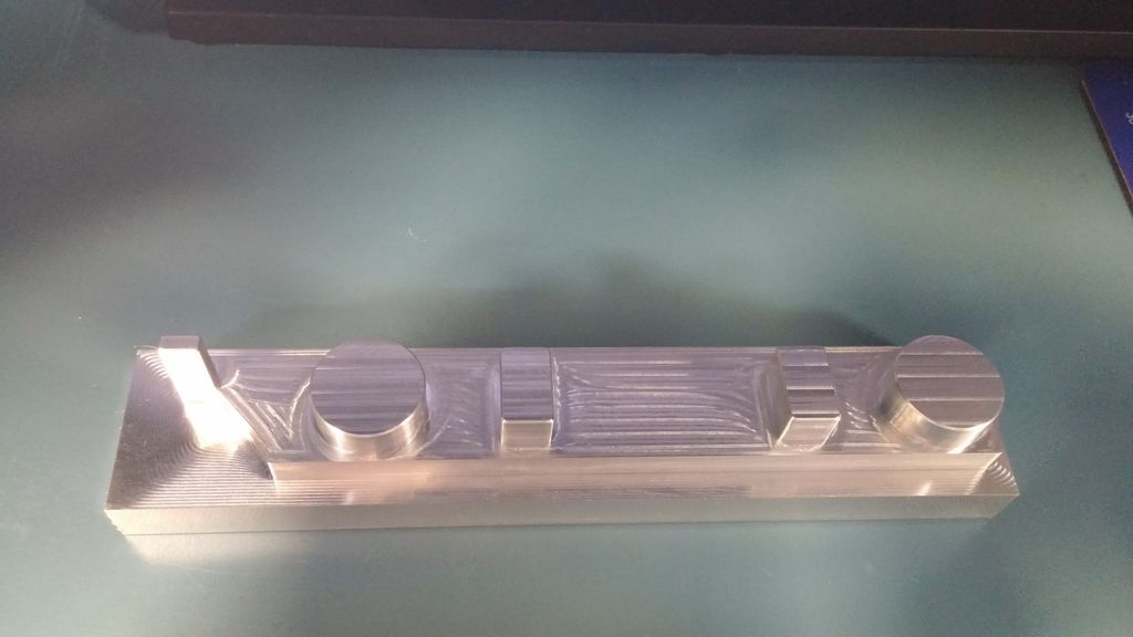

Ok new version. Had to make a couple of adjustments and finish the other side. Added a .03 radius on the bottom of each boss, .025 chamfer around each boss, Pocketed the back side with .03 radius from the floor to the wall and another .025 chamfer around the top.
cut to thickness, pocketed and spot drilled.
Drilled and tapped for keensert.
Keenserts installed.

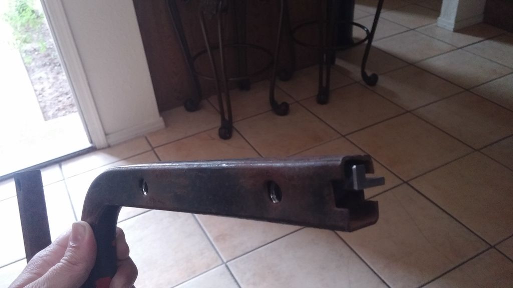

next to the trunk hinge.
and it fits. still has room to move around. Now I can put on my deck lid.
