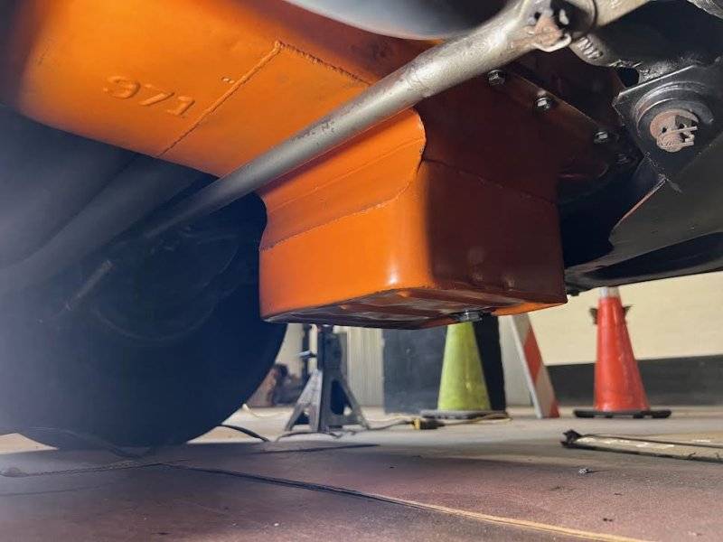

Stg3 This pan by Moroso though looking very sturdy and well welded, the kick outs will interfere with my custom headers. Thank you though.
Here's an of image of the pans oil well rear wall. It's a simple 971 Moroso 6 quart pan modified with a semi-ellipes rear wall to clear the center link movement. This is what I was thinking of having fabricated in aluminum.

Funny thing is that both Stef's and Canton are relatively close to me. I can take a short drive and see their operations first hand and also pick up an existing pan that I could modify to my specifications. I have no scraper or trap doors in my steel pan, just a baffle and a center 1/2 NPT pick up.
The morose pan above I have on my 69 charger with a hemi 2nd gen . The drag link hits pan when turned all the way right and left haven’t figured out what I need to do to fix it FYI
Check the photo of what I did to my Moroso pan. It clears very well. That is why I would want a replica strictly following the modifications that I did in aluminum if anything. Not in a hurry though.
