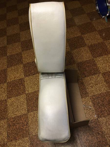

I'll check on measurements. Legendary made me a new cover for mine.

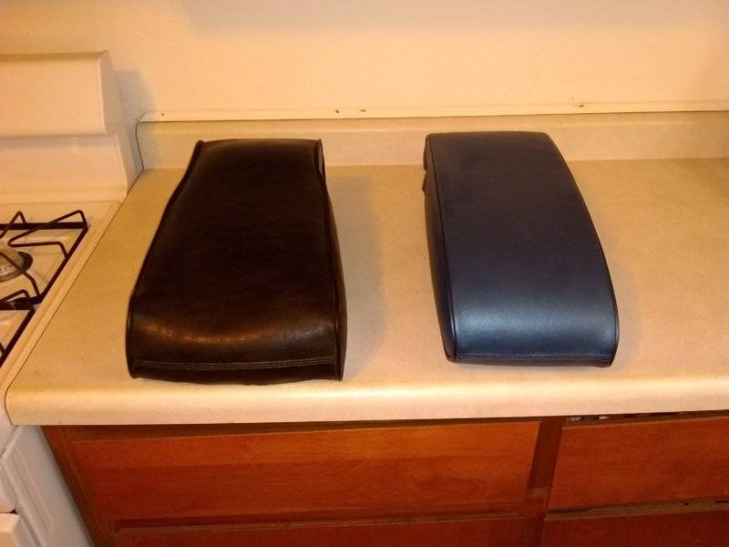

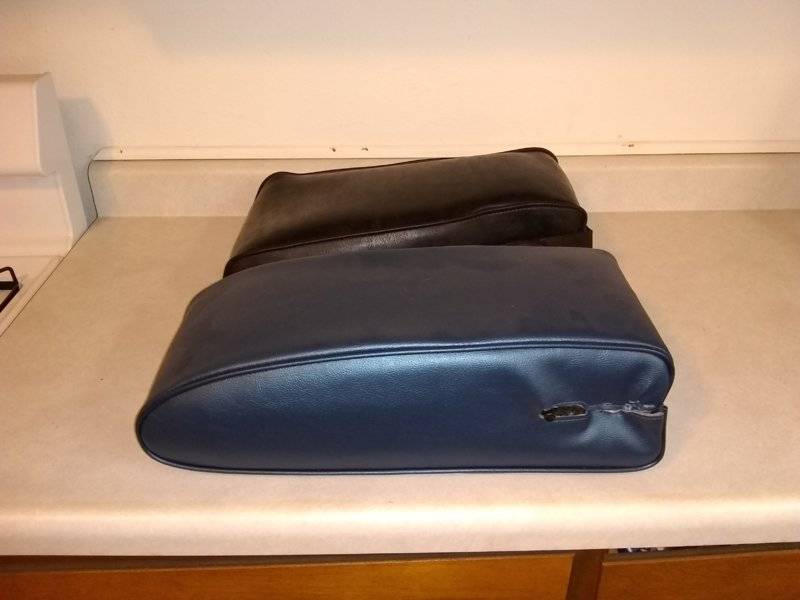

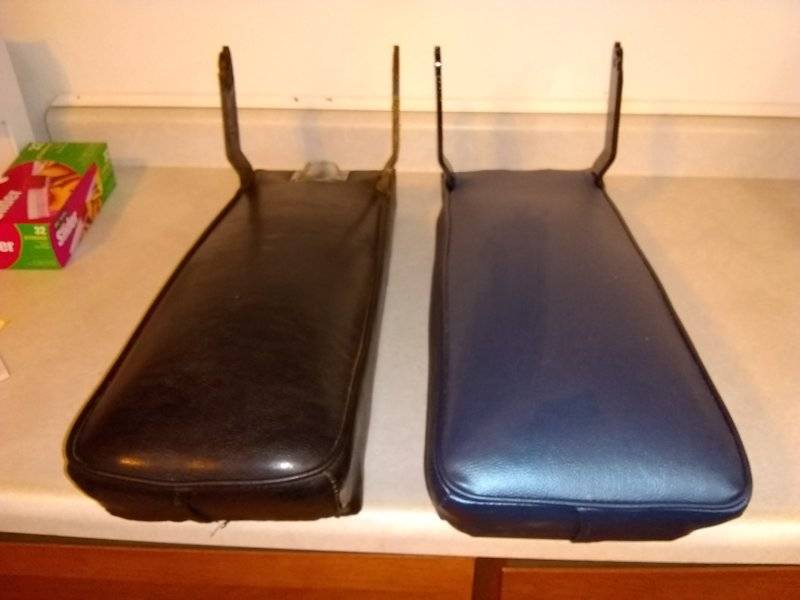

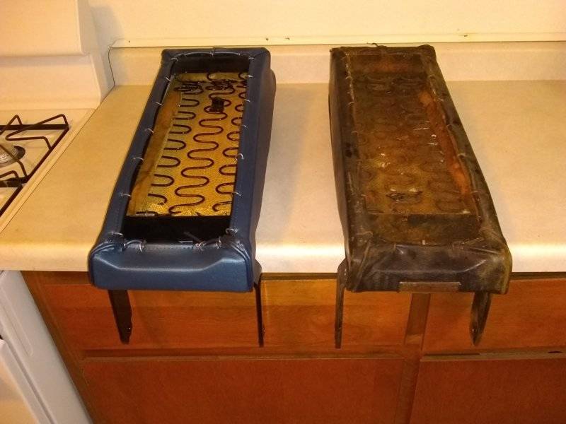

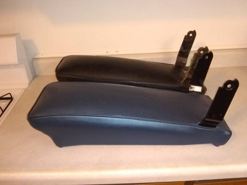

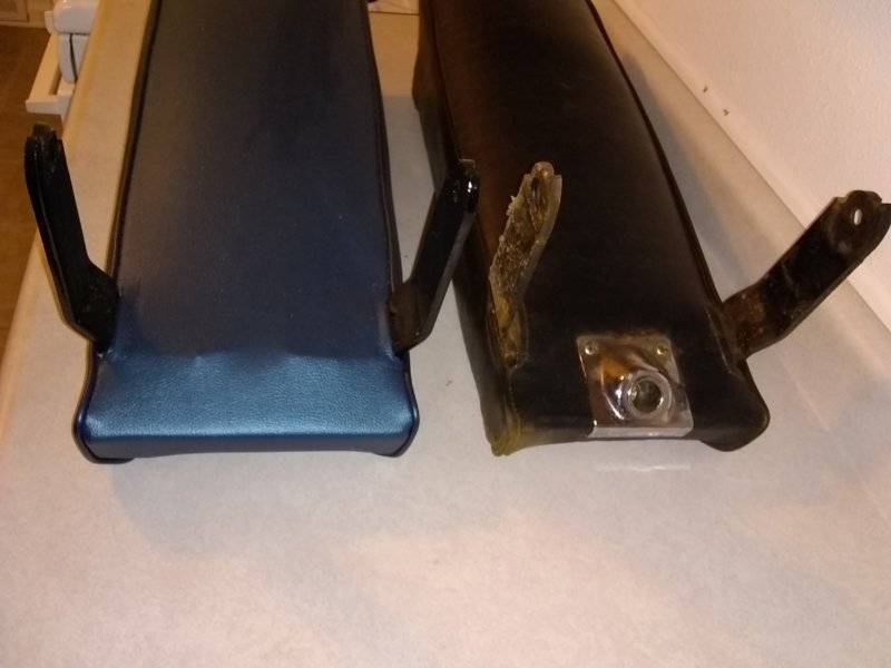

So here is a comparison between the one I bought for parts (black) and mine (blue for the GTX). As far as I can tell, they are the same frames.
Here you can see the lighter. I was told this was from a C body, but I can't confirm that . Obviously it's out of a luxury car. The frames look identical, now the covers vary a little, and that might be the only difference. They both are the same length, but the black one is a little wider at the front
Let me know if you need anything else.
Thank you 69GTX for the pics. Waiting for mine ,in the mail.I will let you know. Mine does have a 2 inch strap on the front bottom pad.The blue looks wider in the pic with the lighter must be the angle..

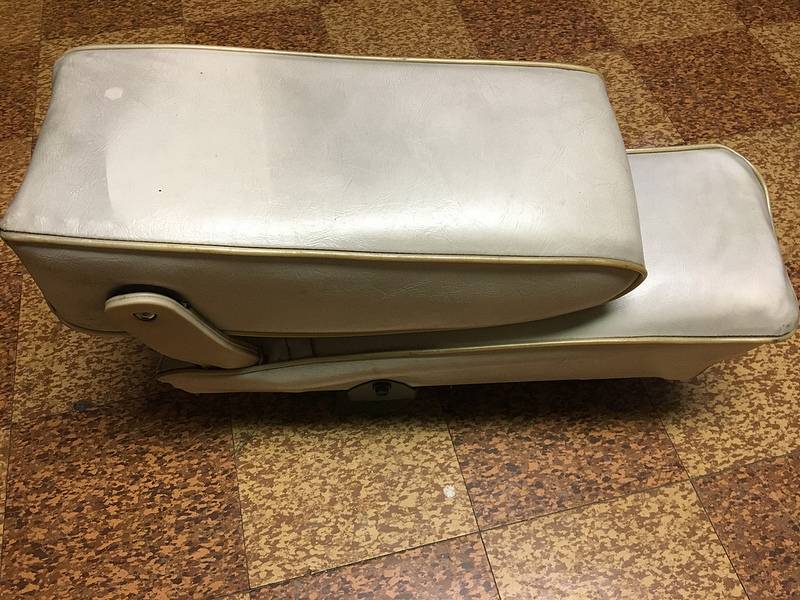

Like this?
The buddy seat shown in the picture below originally came with my 68 Charger, while the front bracket, I'm told, came from a 69 GTX. I'll trade the narrow bracket for the wider one if anyone is interested?
Yes, the front bracket shown in this pic is the wider one like my 68 Charger.

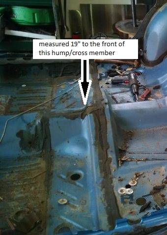

I took some measurements. My car has full interior and carpet, but it should be a good starting point.
From firewall to front bracket was about 32"
From the trailing edge of the rear bracket to the "hump" under the rear seat was 19"
I couldn't pull the carpet enough to measure to the seam in the pan. So I used the front of the hump as a point of reference. Hope this helps.

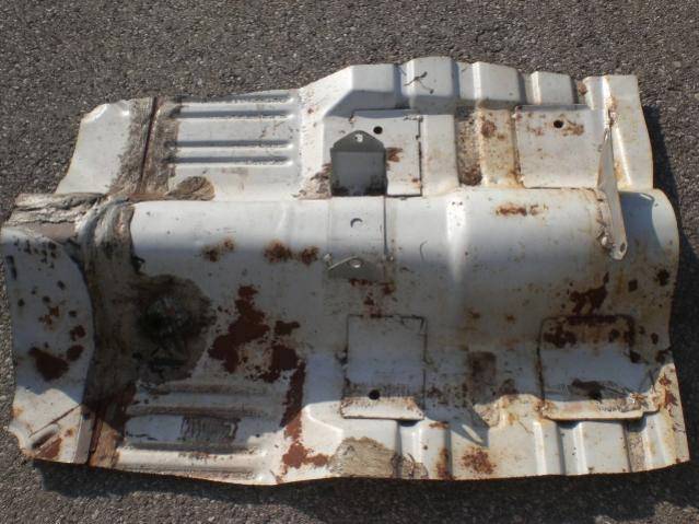

There should be dimples and flat spots in the floor pan for all three mounts- floor shifter, console, and buddy seat.
