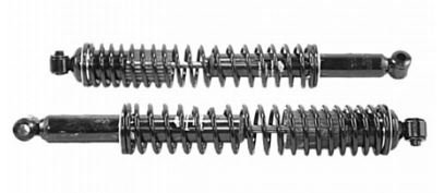

About 5 yrs in, the 1" over was gone and the wagon sat level. A few yrs later, I added coil over shocks to help with the occasional load as my wagon was my daily driver back then.
These shocks for those not familiar with them......
In 2009 I stopped driving the wagon every day, and by 2010, was not driving it at all.
Currently, wagon still sits level, but I don't know if its because of the shocks or the springs.

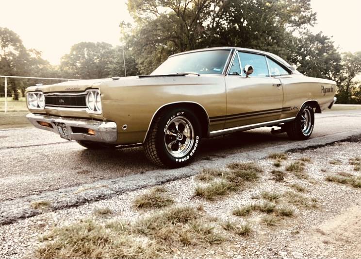

Hate to say this, but my ESPO springs which were ordered as stock replacement springs kinda sagged rather fast. Without any thing in the trunk or passengers, it sits pretty at stock level ride height, but add anything to the rear and they take a dive. I should have maybe ordered Hemi HD springs instead. Here's a picture of how it sits empty. Perhaps I will try Detroit Spring when I drive out there again.
