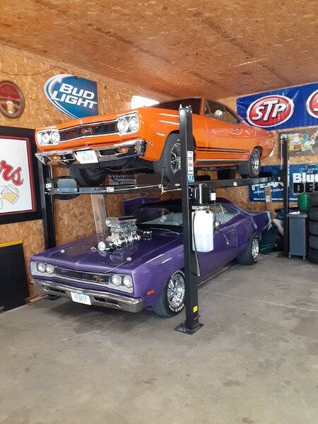

I've seen your garage, a 10 car carrier is NOT enough!!
Maybe 3 to come close. Just don't forget the coins.
