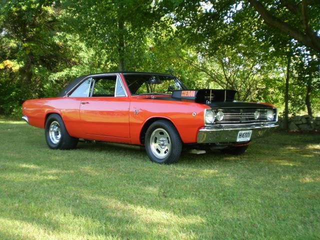

Nice lookin little A body you got there.
