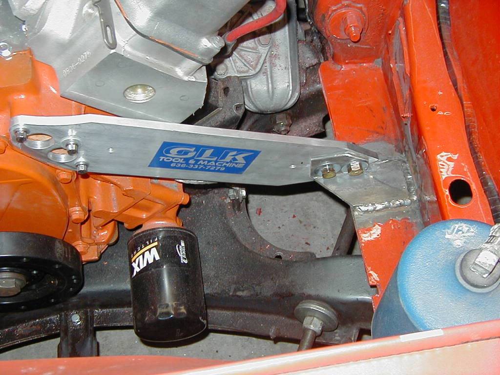

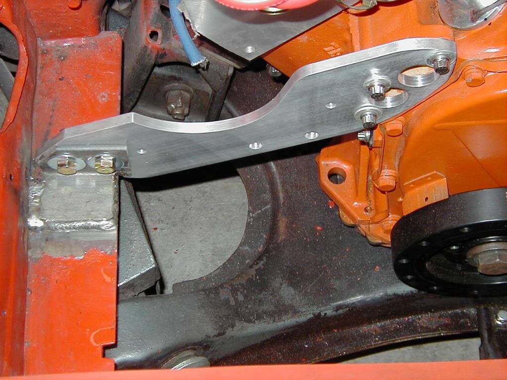

How do you have the motor mounted? Solids,front plate,elephant ears ect... ??? I am using a set of elephant ears because I was advised that a 650hp motor should use them. Of course I prob. have made more work for myself.
How does this look?
Bud...You Dont Use BOTH The Motor Plate AND Motor Mounts....All Ya Need Is That Beautiful Piece Of Aluminum Up There....
WHATEVER You Do NEVER NEVER NEVER Put A Solid Rear Mount On The Trans Of A Long Tail......It Will BREAK..Believe Me!...
Good Luck!..Nice Job On The Mount Install.VERY Similiar To My Super Stocker.
SS
AND I Would Have Put The Angle Solid Mounts To The Rear Instead Of In Front Of Your Solid Engine Mount.That Way When Doing Engine Changes You Will Be Able To Get Trans/Headers Hooked Easier....

Thanks for the input on the no mounts and ears together. I guess I need to put a disclaimer when I posted those pics. I was only using the stock mounts as a template to get the motor in the stock location but thanks for the help.

I Got To Thinking About That Later And Thought That MIGHT Have Been What You Were Doing.
ALSO What I Meant With Changing Engines Is I Have Mine In And Out So OFTEN(A GOOD Motor Is Usually Only In My Car For About 5 Passes Or So...)..Then We Either Take It Out And Put A Lesser Motor In For REGULAR Shows Or Have Scattered It By Then..Any Ways If This Is Only Gonna Be A Street Driver And Occasional Strip And You Didnt WANT To Have To Have The Elephant Ears On It THEN You Can Get Some Schumachers Polyurethane Mounts That WILL Handle The Power.The Schumacher Mounts Are Excellent.You WILL Have Problems With The Angle To The Front Trying To Get The Engine Into Place With The Ears Already Installed As They Are.

I am not understanding what you are saying about not getting the motor in with the angle of the ears the way they are? I have the motor and trans mounted in the pics that I posted?
The mounts that I have in the pics are the Schmacher poly mounts. The poly mounts were OK but the stock mounts to the motor were bent and the holes were wallowed out so I upgraded. This will be 95% strip 5%street. The poly mounts could have been fine but the elephant ears look cooler. If you can't be fast,look fast!:grin:

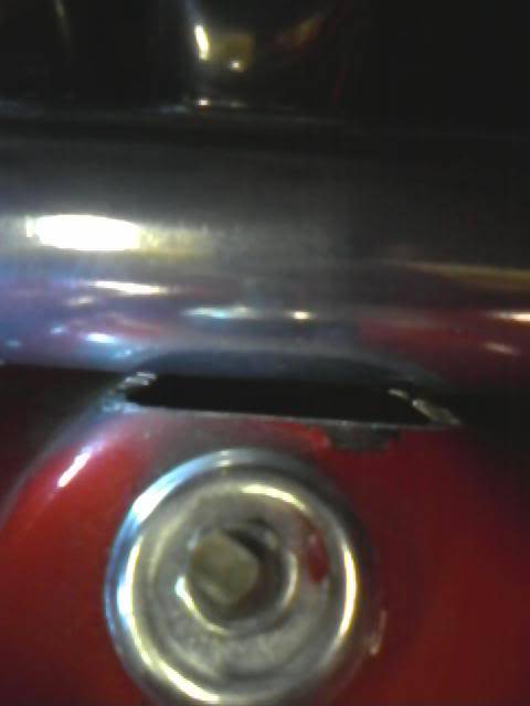

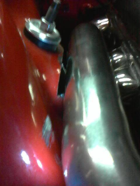

PoppaJ could you post some pics of the front and pass side of your motor? I am having header clearance issues on that side. 2" Doug's reg exit headers, I had to notch out the shock tower to make room for the tube. It was laying against it so I notched it and need to weld in a piece to fill it in. I am probally the only person to have this issue:( but thought I would ask. If I messed it up, well it is to late now.

I will take some pics for you tomorrow Atomic. Seems strange that you would have to do that. Is motor in stock location??

Yes, I bolted it up today and the trans bolted up to it easily and the trans went in the crossmember easy enough also? Trans is also centered in the tunnel.The pics of the tower is MISLEADING 1: I cut to much off. 2:After I bolted them up they were rubbing on the tower point. If the motor was out I could have taken a ballpeen hammer and put a small dent and then they would have cleared. I had the motor in and out at least 5 time in 2 days so I thought the easiest way was to drop the header out the bottom and cut it out. The old headers (1 3/4") were real close also. 3: I could have left it alone and let it rub but didn't want it vibrating on it. I thought that I read in an old Mopar mag that they did this in some of the old super stockers to get the headers to fit.
I hope I haven't totally screwed this up but I most likely did!:black_eye: I should change the name of the car to ATOMIC BOMB

My 2-1/4" headers touch against the shock tower as well. I will post a couple of pics. AS far s your shock tower it is a easy fix so don't sweat it. Believe me over the years I have done a lot worse boo-boo's. The way I look at it you are out there trying to do it on your own, my hat is off to you! You will get it.
