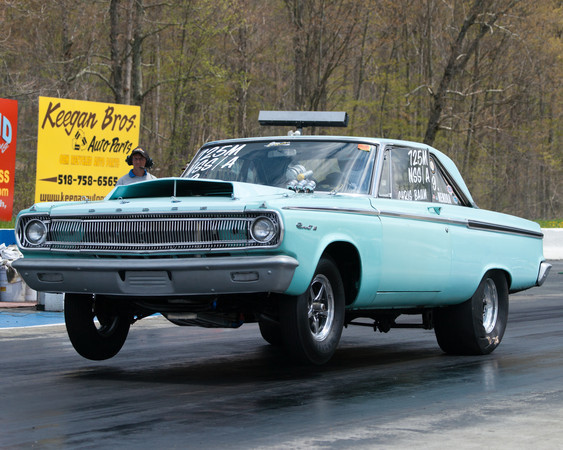

Bring the car up to Vignogna's shop on Saturday, We can weld them in there. I need to get my wheelie bar brackets welded on to my dana 60 also. Cant believe i'm putting wheelie bars on my 65 dodge coronet.

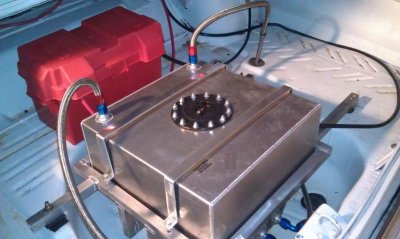

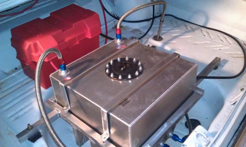

fuel cell.jpgFuel cell straps have been completed,,, added some nice foam padding under the cell between it and the square tubing framework. Added rubber strips between the straps and cell as well......
View attachment 172783Fuel cell straps have been completed,,, added some nice foam padding under the cell between it and the square tubing framework. Added rubber strips between the straps and cell as well......
That's a fantastic job. I love the workmanship you put into that.
outstanding.

opposite side of the cell framework houses the electric fuel pump.

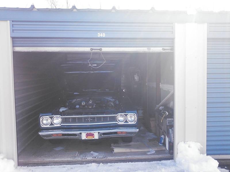

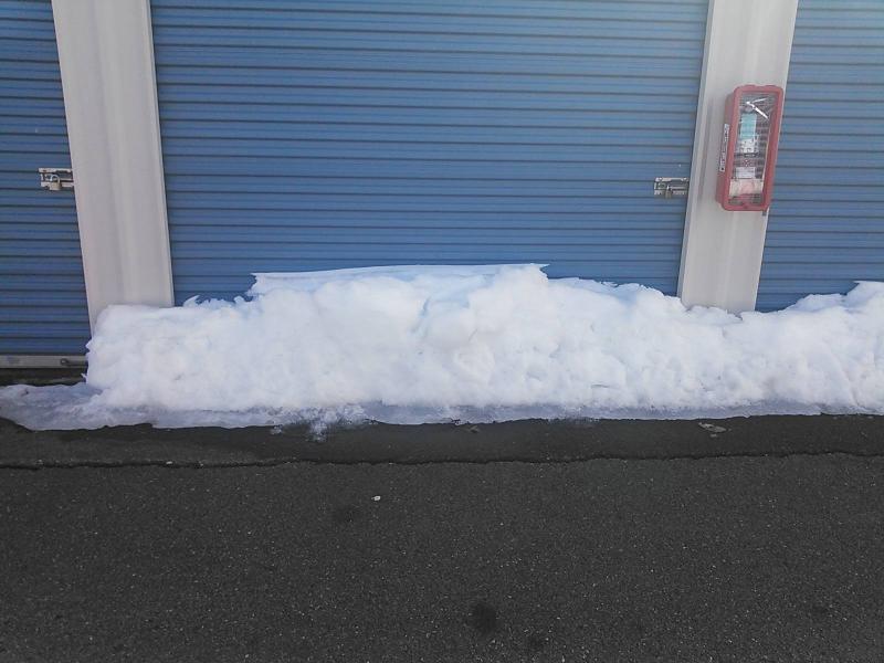

storage 1.jpgWell, the day started out nice. I got over to storage, shoveled out the GTX, and it started right up. Drove to the shop where I was going to install my torque boxes and subframe connectors. Nice drive, the sun was out and got to about 55 degrees. Then the car went on the lift. I noticed that the two lower leaves on my springs were slightly cocked. When I investigated further, I saw the front spring perch was tearing away from the frame. I had replaced the rear portion of the frame rail years ago, but the front looked fine, so I left it. I also noticed a small hole now in the front segment. After poking around a little, realized that a portion of the front segment was soft. So now I need to replace the front segment or get a complete rail for that side. I'll also need to replace the spring perch. The passenger side is fine. So, with that, maybe I won't be ready after all.
