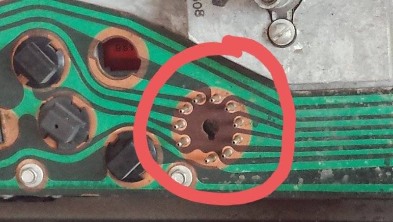

Hmm, I don't remember it was a brand new circuit board though.Did you replace the gasket under the barrel connector? Between the cluster housing and back of the circuit board is suppose to be a gasket. The only reason I know was that I forgot mine the first time and got random short to ground issues as the back of the pin connectors made slight contact with the housing. With blown fuses it might be a possibility.
