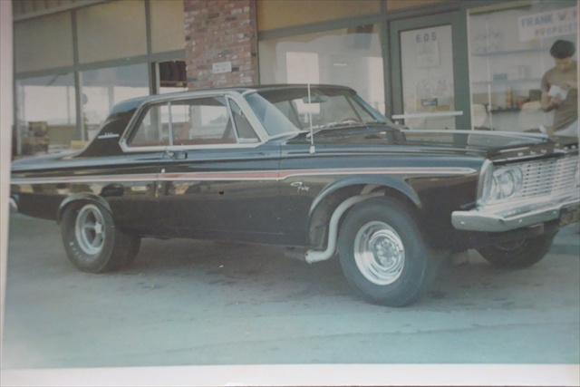

This is a picture of my old MW race car back then most of the SS
cars had a nose up attitude.
The idea at the time was weight transfer to the rear during a launch.
In my case it was for oil pan clearance as it only had 3"
