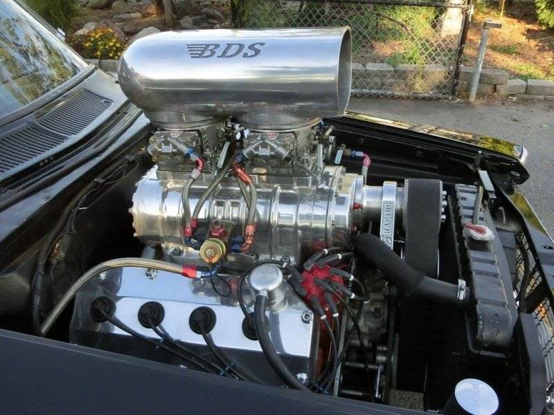

Yes, even with fuel injection. The oil pump is a missle dry sump pump and we machined an adapter for it to drive a cable drive fuel pump. Fuel pump is a MagnaFuel Pro-Outlaw 1000. Car runs mid 5s in the 1/8 mile and drives all around the Midwest. Even has air conditioning.
