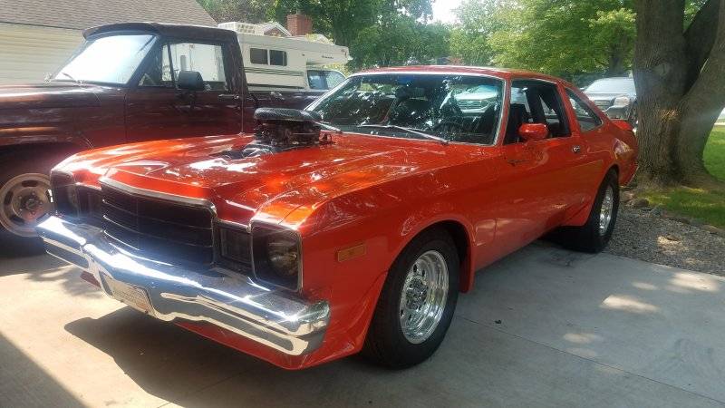

We broke a trans cooler last weekend. It was mounted between the subframe connector and the drive shaft. Under the the drivers seat. Fortunately this kept all the fluid between the frame rails. But was even dripping off the deck lid and tail lights. When cleaning the underside I washed the wheels and took a look at the recently installed 5/8 studs. The picture is the spokes of the rear wheel at the hub next to the stud washer. Every spoke on both wheels is similar. Ran this car for close to 800 passes. Converted to 5/8" studs this Winter. Never guessed the old 1/2" studs were stronger than the wheels.
Doug
Everyone runs those 5/8” studs with the aluminum spacers but I don’t like the fact that the wheel can move on them. Lots of guys using aluminum lug nuts as well. My 1/2” studs have shanked lug nuts to locate and center the wheel. Just seems to be a better setup.

Just don't like the look on this car. They are from my street car.
Doug
They must have grown on me over time....
And BTW, I liked them when I saw your  street car last year at Norwalk...just sayin. :thumbsup:
