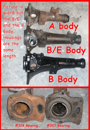

Not behind 318's. Slant 6's and early 273's only. (64 and 65 I believe) The tailshafts and shifter locations are different between the body styles.
