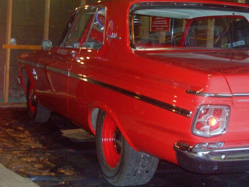

100_3853.jpgI want brakes some day... my drums are like a scary movie:happy1: & I'm in it!
