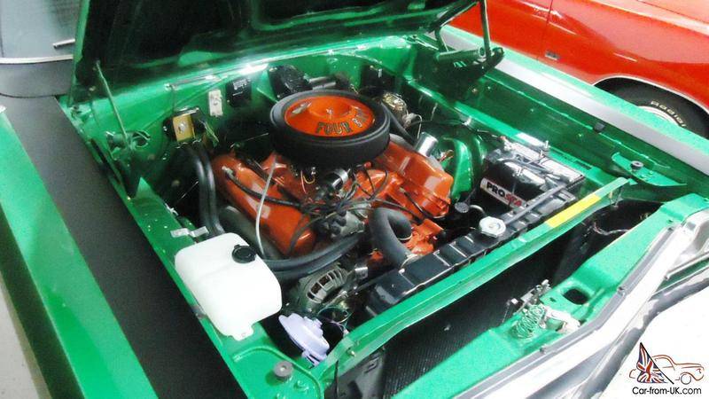

The only other difference I can think of is that you will need to remove the bracket at the top of the fender that bolts to the top of the radiator support
Correct, the brackets are different.
1968...
1969...
I also think GTX headlight bezels are different from RR because of the grill center section.
thanks again guys .
those pics are great certainly show the core support difference.
