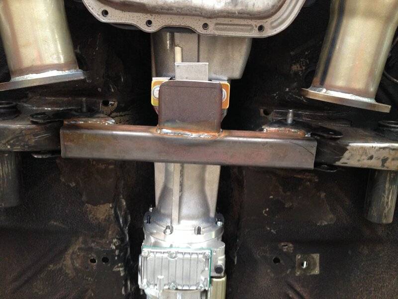

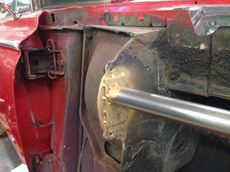

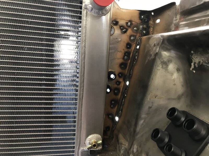

With it moving engine back wouldnt that cause trans not to bolt up right to cross member

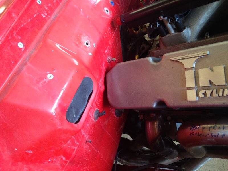

Yup. Had to deal with that too. Especially on mine since I'm adding a Gear Vendors unit. You will also have to massage the pinch weld flange above the bell in the tunnel area. You will end up with about a finger of clearance around the bell which still allows for some airflow around it. Also put a shot in of firewall to V.C. clearance for you. The area around the G.V. unit needed some work due to the mass of it. If you run a standard 727 it should not be an issue other than playing with the mount.

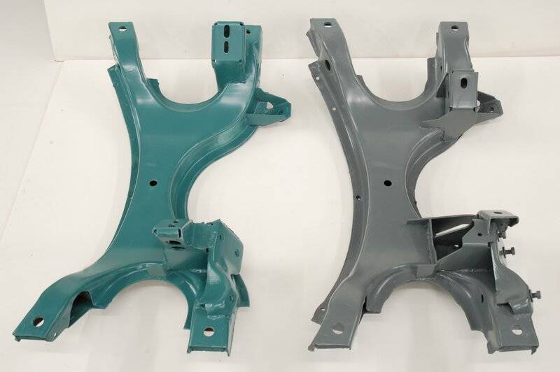

It can be used but it moves the engine back. There are benefits to moving the engine back but also some pitfalls that you have to engineer around. I wouldn't move the engine back unless you know what you're doing. Probably best for you to find an original K frame. I'm sure they are out there. I have a spare that I keep on the shelf even though I most likely will never use it. Just haven't gotten around to selling it yet. Here is a comparison between early and mid B body.

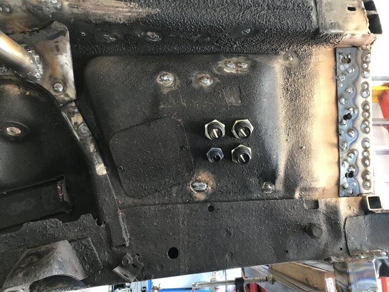

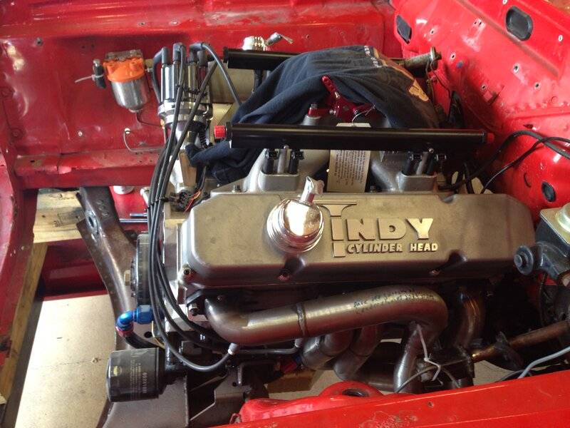

If installing a small block how is clearance for the distributor?
Just curious.
No clue. If the engine/trans was in the car I could give you a pic or two with some measurements. From there you could maybe get an idea. You would need to see what the difference is between the two engines as far as distance from bell flange to back of head, see how far the distributor hangs back from the block in relation to the bell flange, height of the distance etc. Probably the only way you could nail it down for sure is just do a mockup with engine and trans. Another possible issue is the hvac plumbing. On my car, as it is an ac car, the plumbing is right where your distributor would want to be. On mine, I re-routed it to between the fender and the fender well. Thought I had a shot of it where I put it but nada. Its below and to the inside of the brace then comes through up front.
