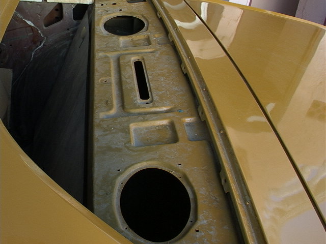

I see two holes: 8 1/2" X 5 3/4" (passenger side) and 7" x 4 7/8" driver side) pre-made in the package shelf of my 72 SSP project car. Don't want to make additional holes in the front doors for speakers. My question is, has anyone set-up a stereo that only uses the package shelf speakers? Are they too far away to boost the sound forward? If I do rely on only those two, I would probably box them so the sound waves don't empty into the trunk. Want to keep the stock AM radio and front speaker as it came from the factory. Will need to "hide" this second unit somewhere else. Thank you.

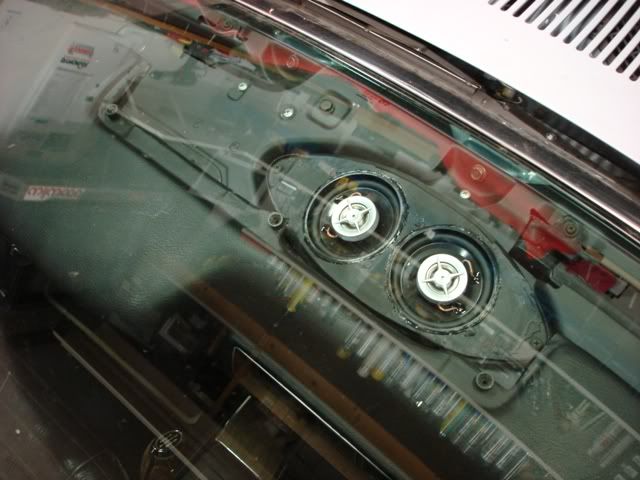

You will find the left opening is smaller than the right side, with additional mounting holes for 6x9” speakers. With some amplification a good set of 6x9s will work fine. May want to consider some decent 3 ½” mid/tweeters under dash speaker grille to improve staging. After the jute pad and package self are installed, shouldn’t need to worry about boxing in the rear speakers.

Thanks for pointing out the different size speaker perforations--weird.
That's because they are not speaker holes. :) Our cars came with AM radios, which had one front and one rear speaker. The other hole is for a rear defroster fan that was an option. That's why the holes are not the same size.
You can make the defroster hole bigger, or just mount the speakers under the tray.

Have to disagree a bit, while a true stereo dual speaker package shelf configuration was never offered in this time period, they are stamped to be used first as speaker mountings. They are standard 5x7” & 6x9” speaker dimensions, with the left side stamped to accept both sizes. The rear defrost fan option components are designed to fit an unused speaker opening. There was a spacer available for the fan intake that would allow the sharing of one opening for both a speaker and defroster if needed. Not uncommon to find factory speaker provisions in package trays dating back into the early sixties where a full factory speaker option didn’t exist.
AM & AM/FM mono radios could be ordered with an optional rear speaker and dash mounted fader control. It was a single 5x7” mounted on the left side. AM/FM stereo optional radio, used this same single 5x7” speaker mounted on the left side for the right channel and the single 4x10” dash mount speaker as the left channel. Balance control acted as the front to rear fader adjustment, not a true stereo layout. Every defroster option I’ve seen, or installed working at dealers back then, went in the right side opening. Never saw a factory 6x9” speaker option on any platform back then.

Agree, central mounted dual speaker don’t provide much separation, in my case it’s compromise, don’t want to cut anything. I attempted to angle the 3 ½” outwards as much as possible hoping to separate the reflection from the windshield as much as possible. Kick panel locations are not much better for good separation either.

Agree, central mounted dual speakers doesn’t provide much separation, in my case it’s compromise, don’t want to cut anything. I attempted to angle the 3 ½” outwards as much as possible hoping to separate the reflection from the windshield as much as possible. Kick panel locations are not much better for good separation either.
Defroster mounted to the right side 6x9" speaker mounting on these cars;
Very interesting, I've never seen one of those until now.... learn something new everyday.
Yep, even the Satellite/Roadrunner Brochures from then, show that if you had an AM/FM stereo or AM/FM stereo with cassette stereo option, it standard to only get the single rear speaker, never duals in the rear. However, even with just an AM or AM/FM radio, the single rear speaker was still an available option.

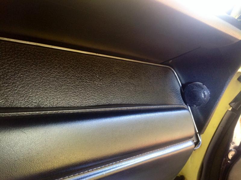

Tweeter glued under right side of dash. Amazing difference.

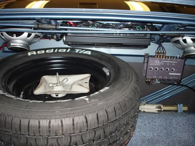

I mount 2 3 way speakers back there and power them with a simple ti path integrated, like this.
http://www.amazon.com/Lepy-LP-2020A...ass-t+hi-fi+audio+amplifier+with+power+supply
Then just plug my phone into it, I put oem radios in the dashes where they are supposed to be but I don't hook them up. Its simple, doesn't pull much power, easily loud enough to hear, and sounds good, if you think you are going to get good quality sound in a car, you are delusional, but I am spoiled. As far as having multiple speakers, 2 is plenty for stereo, lol...
