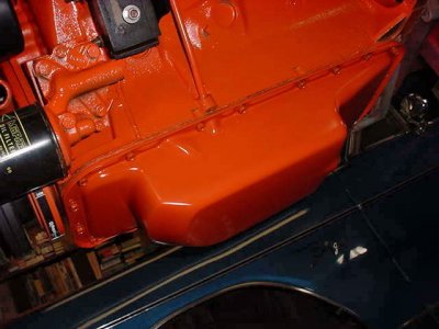

Simple answer,no.The early pan is 5" from the front edge to the beginning of the sump,the Hemi pan is about half that.Here is an origional Max Wedge pan,you can see how far back the sump begins.
