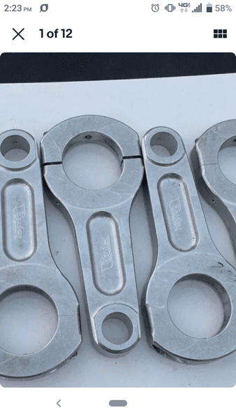

Will these rods work with my forged crank 383?

Yes. What are they? Chinese H beams? Kinda hard to find.

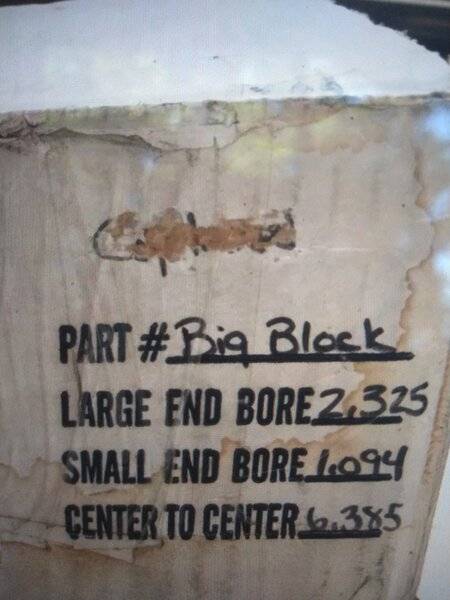

Stock 383 Rods use a 2.375" large end and a length of 6.358"
The box lists the large end at 2.325" and a length of 6.385"
If possible I would measure the rods as the "2" could be a "7" on the big end and the length could have been hand-written inaccurately...
I agree with Dwayne. If they were BBM they would say mopar. If it just says "big block", assume chevy.
You could use them (I wouldn't use used aluminum rods) maybe (maybe!) on a small stroker ground to use BBC rods, but why? The custom pistons necessary would be expensive, and the huge mopar pins would cancel out the weight savings of using aluminum rods. I bet a good steel rod with BBC pins would be lighter.
Those rods are probably from a used-and-abused heavy power-adder big block Chevy (the mopar pins).
If I were building a killer high rpm 383, I would get a set of rods from Molnar, 100%.
