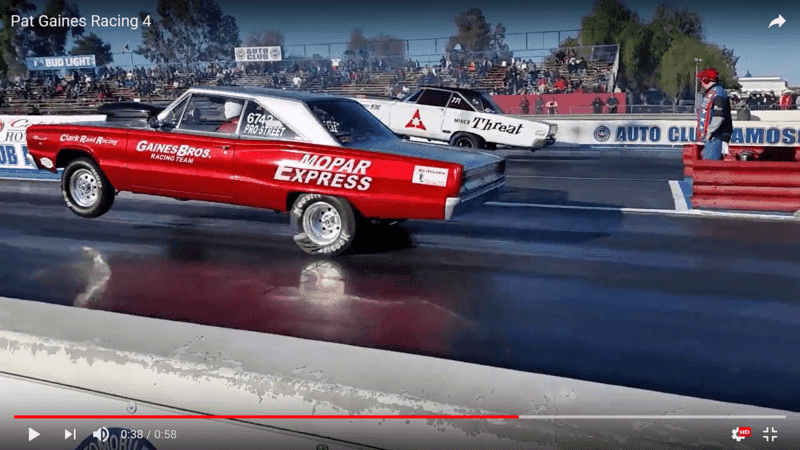

I said I wasn't going to spend any more money on my car and be happy with [email protected] but.....maybe I might get the urge...
I have cal tracs with mono leaf springs, cal trac 9 way adj rr shocks and cal trac 90/10 front shocks.
Trans brake launching @3600 off the chip
My typical 60' is 1.40 when I go 10.15 to 10.17.
I know I need to launch at 4000 to 4300 but when I tried that with my current setup I lose traction and the car spins to a crappy 60'
How can RR Vikings help my 60' ?
and how much do they cost and can I just use rr or do I need frt also ?
The top picture is a screen shot of my typical launch.

Here is Video of a typical 1.40 60 foot launch. NOT in slow motion but you can click/click along the way to freeze frame it to see it step by step.
PS: Cal Trac wants the car to lift in the rear exactly as it is doing.
They also wanted 5 1/2" of free travel in the front, which it has...front actually "lifts" 5 1/2" before front wheels come off the ground.

It's odd being all B bodys being the same front suspension until 70. Mine won't come close to 5 1/2". Anyway nothing the matter with too much travel. Can easily be reduced if not needed. The trick is the speed of the travel. Cal Tracks lift in the rear due to the short I/C. Again we want to control the speed at which it rises. This is all done with rebound adjustment. Let me get a look at the video and then we'll talk.

Mike I went through this whole thing and knew you would be too. You need to get some shocks on the front that has the rebound adjustment. Slow the front end rise by putting a fair amount of front rebound in and tighten those rear shocks right up. You'll see.

D, the method I use to get 5.5" of free travel is by un-cranking the torsion bars and letting the front end "sag". I loosened them up enough to get the 5.5" of free travel which is what Cal Trac wants.
To get the measurement of "free travel" I measure from the ground up to the fender well lip...lets says that measurement is 30", then I jack up the car until the front tires just barely lift off of the ground and then take the measurement in that same place....It then shows 35.5", or 5.5" of travel when the car launches before the frt tires lift off the ground.
Note: I don't have the exact measurements here at the computer with me so the 30" and 35.5" are fictitious numbers just to make the point...but the difference is 5.5"
2nd Note: This process did throw my front end alignment kinda out of whack as the top of the tires "lean in" a little bit while at rest...I don't remember if that is termed "positive" or "negative camber. And this does cause my tires to wear a little more on the inside treads but I don't drive it on the street for lots of miles so it doesn't matter.

For sure, big power. The NHRA factory stockers weigh 3525-3575. The point I was making is they can hook with well over 1000 hp on a small tire. Your car 60ft will probably stay high 1.3- low 1.4. However it should repeat w/o spin reqardless if a little nose weight.

Yes, you're a tad too far to pop over and help out. Lol. I think that you're closer than you think. You took a bunch of weight out, not in the best places and without cranking up any shock rebound. Take another shot at it.
