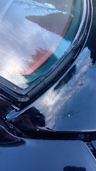

Maybe you know this. But looking at your picture. The outside flap of the gasket tucks under the outside inner portion to compress it against the glass for a seal.
No, I did not know that. But that makes sense. This is the first windshield I've ever installed and the youtube videos I watched left that part out. I thought it looked kinda unfinished.
So the outter part tucks underneath. Hmmmm..... I need to do that and do another leak test. Appreciate the helpful info. Thank you so much! This is why I love this site!
59 was right. The rubber gasket needs to be tucked in. I did a water test and the leaks are gone. I probably would have figured this out when I installed the chrome molding but knowing this now was very helpful. See the pictures for how the flap tucks into the gasket.
