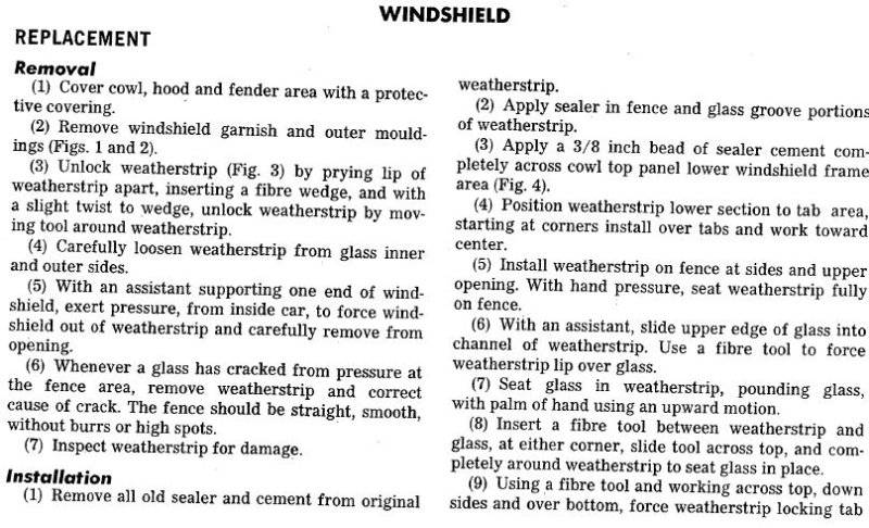

Working on 66 coronet, anyone here ever installed a windshield on this model? Need info and photo's on how the bottom of the gasket sets on the cowl. What type of sealer are you using in the lower part? The sides and the top are easy as the gasket sits on the pinch weld area. Any how to or videos ? Can not find anything on the web. AND yes I have the service manual.

It is in the FSM.

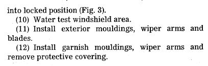

Installation step#4 what are the tabs??? Does the gasket set on top of them? Any photo's. Yes I have read this in my manual and looked at the drawlings.
The tabs are on the lower part of the opening. Look at your car.

Are there only 3 tabs for the lower rubber? does the rubber sit on top of the tabs?
Thanks for the video, It still does not show how to locate the gasket no the lower cowl tabs .
When I removed the gasket on my 65 it was set over a strip of white foam-I think closed cell. Maybe 1 1/2" wide, full length of horizontal flange. I believe it took the place of butyl caulk.
